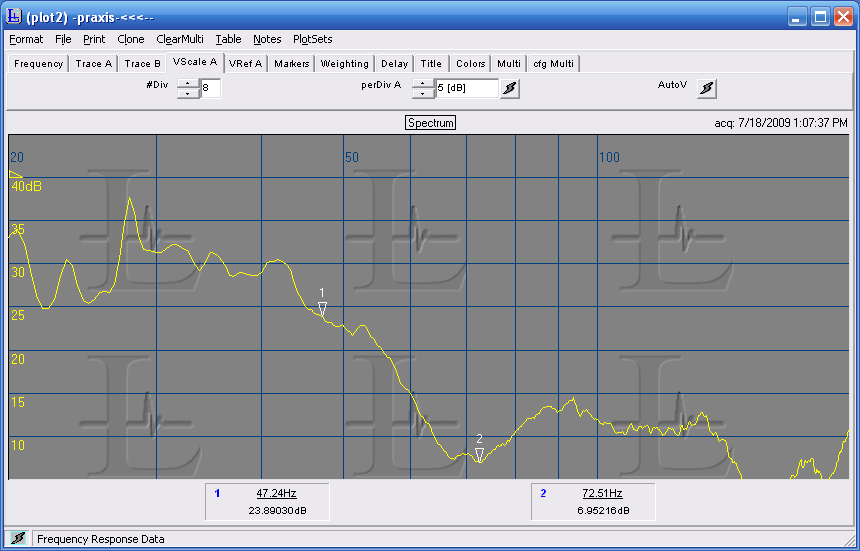

Of course you may now be thinking "ported boxes don't sound good though, they're boomy." That leads me to the second part of accurate reproduction and that is flat response. When wanting to get flat response, it is important to realize that it is the whole system that has to be looked at and not just the drivers alone. The woofer is part of the system but without taking into account the vehicle transfer function and the enclosure, the woofers response doesn't mean much. This happens in a home theater room, recording studio, night club, etc. As a result there are two things you can do if you want flat response.
Again keeping in mind our goal is for the lowest distortion, we look at using EQ to correct the response of the mentioned ported woofer. EQ is your friend. We really don't care what the response was before because we're going to flatten it anyway. We were only concerned with getting a given SPL with the lowest distortion. Putting that vented box in the vehicle may give far too much low end output. That is ok though. In fact it is great! If you have 20dB extra headroom at 30hz for example, that means you can get away with literally 100x less power at that point that at say 75Hz. Using EQ to flatten the response, the low end is brought down to the appropriate level. Any bumps in the response curve are corrected for. What is left is now a system where the woofer doesn't need much power, doesn't need to move much, and as a result has extremely low distortion output with a ton of headroom for transient peaks. In most cases where EQ is available I will design a system this way. You do also want to remember to tune low enough to get the rise in group delay at tuning down to an inaudible frequency. I will often tune with PR's in the area of 20hz. The low B on the bass guitar is around 32hz. Low A on the piano is 29hz. Most electronic music doesn't reach much lower. As a result nearly everything is covered cleanly well above the tuning frequency.
Now the other method, which is most often used is to try to get the enclosure rolloff to approximate the inverse of the cabin gain. Often times this is done with a sealed box which will begin to roll off much before the vented box would. This will help to tame down the low end but can't help to deal with the bumps and still won't really compensate for the cabin gain. A sealed box will roll off at 12dB per octave. At some points it won't be enough. At others it will be too much. The following was the transfer function in BumpinBuick's 4 runner. From 67-53hz the gain increases at about 30dB per octave. Below there it drops to about 12dB.
The sealed will give the closest approximation to flat for a box just put into the vehicle. This approach is easier than EQ'ing the system and less costly. However, the properly EQ'd vented/PR system will overall have the ability to play the cleanest and have the most headroom for dynamic transients down low.
