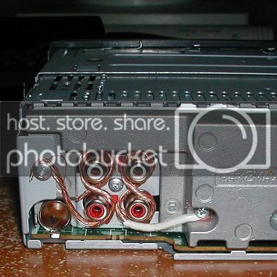

The ground I am talking about did mainly cause static. There was a bunch of griping done about newer Pioneer units at the time, and the 'fix' was to wrap the outer RCA shield with bare wire, and ground it to the deck, since Pioneer didn't manufacture it correctly.
yea grounding the rca jacks helped me. sorry i thought you meant amp ground. my bad hehe //content.invisioncic.com/y282845/emoticons/biggrin.gif.d71a5d36fcbab170f2364c9f2e3946cb.gif
i have the same headunit. and in our case, since the rca's are on a harness, just get some remote wire, put it into each rca, connect them all. then grab some speaker wire, attach it to one of the bolts on the headunit chassis. then attach them all and put electrical tape, and you should be set.
my whine went away, it was horrible before i did the trick.
