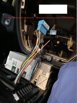

The headunit came with a prewired harness that fits the existing car connection BUT.... when I connect it to the car nothing happens. It wont turn on. This should be simple plug and play, am I wrong to think this?

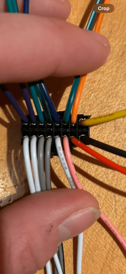

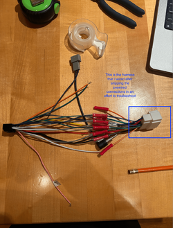

2: Because the pre wired harness was not working I bought a wiring harness compatible with a 2000 Honda CRV and snipped the prewired harness and then rewired as followed in an effort to troubleshoot:
Here is the harness I bought: https://www.amazon.com/dp/B004W34BOW/?tag=caraudiocom-20
Yellow = 12v constant power
Black = GND
Red = Ignition
and then the remaining speaker wires to the correct corresponding wires on the harness....
After all this STILL NOTHING....it wont turn on.

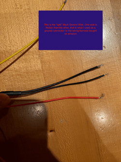

This is more of a question than an issue but the black GND wire is split (I havent seen this before) one side of the wire is thicker than the other and that is what I used to connect to the harness, the other thinner end of the black wire I capped off. What does this mean? Anyone know why it is split? Could this be a reason why its not working?

Twist both grounds together. Good call on checking power with a multimeter. I assume you have pulled out and re-inserted the fuses, so as a quick test, connect the radio direct to the battery. Both Red and Yellow twisted together. Make sure all other wires are not exposed.
