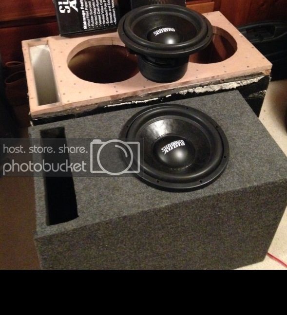

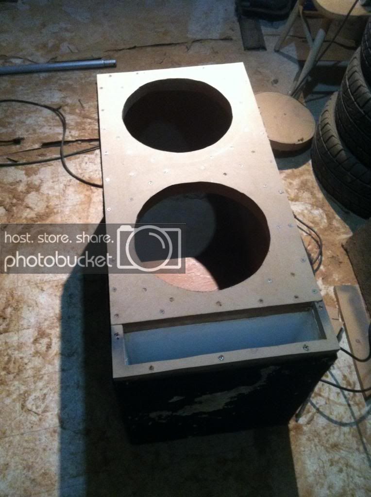

Anyways, box is 34 wide, 20 tall, and 17 in depth.
image_zpsb204fe96.jpg.html
Not too bad ..at least its no prefab
Could use carpet but that stuff on the side is from being sealed off in my friends trunk
