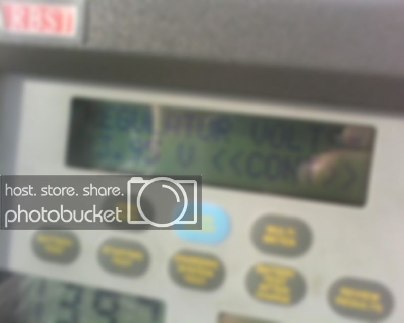

Autozone does have the proper machine to give you an estimate of your alternator puts out at idle/full tilt. I believe most carry two types of testers. the first test is bringing in the alternator and setting it up inside the store to test diode pattern, voltage regulator, etc. The 2nd test is keep the alternator on your vehicle, while they bring a cart outside. And yes, they clamp the +. They do place a HUGE load on your alternator, which makes your alternator work at its best. I took it to autozone, buddy of mine works there, so we took our time and here were my results for my 200amp alt:
Alternator rev @ 1000RPM
Alternator reved at 1500-1600rpm

is this the same machine as my picture?

ok, so after going to every dam parts store around my house....i find an Advance with that same machine. IDK about all the different tests, but i know when we load tested my alt @ 2k rpm it was putting down 275a @ 13.8v and like 68a at idle. then the battery test was all good too. i could see it slowly discharging after the engine was off.
i was surprised/impressed/happy.
