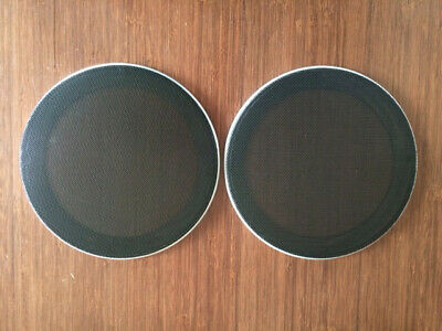

Second pic looks like it is pretty Flat.. You cut out the ABS for the Diameter of the Speaker and you can use a Larger Grill Cover if the Speaker is larger than the 6.5. and may not clear the speaker.Just look for 6.75 grills or larger

Got a suggestion for tools to reform metal grills into a non flat, non circular shape? I was thinking a hammer and chissel type dealio, but I'm not sure that's going to look clean hahaha! Any suggestions? Thanks for all your help!
