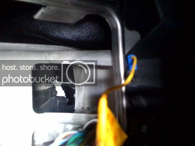

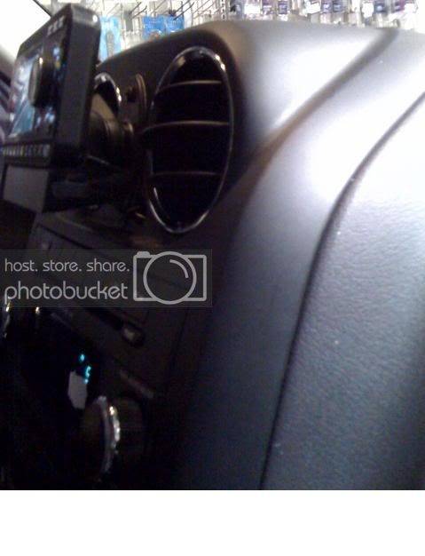

well i had another one come threw a guy went to another to a shop to get a xm sat radio installed in his jeep commander, well needless to say it didnt even come on period, ill explain with the pics

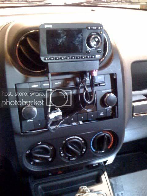

1).this is what i got in the bay

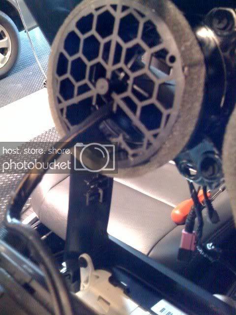

2).so i pulled the xm unit up and out to see where the wires were ran from and found this

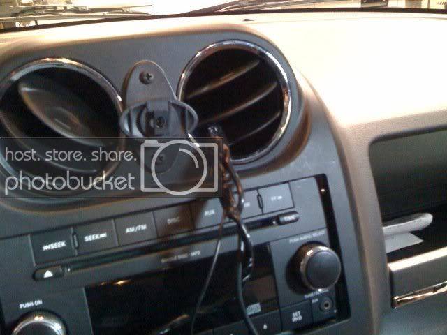

3). They broke the customers a/c vents to run the wires threw.......
4).wow......

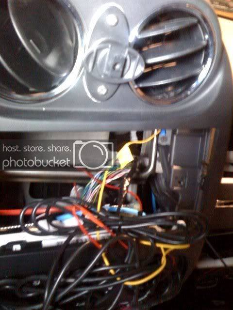

5). how can u ground the 12 volt lead and expact the unit to come one??? for one its yellow, two it stated on the wire it goes to 12 volts???

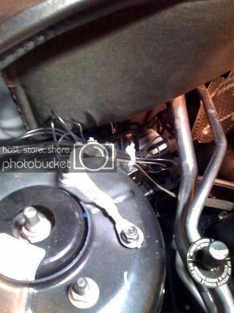

6).The antenna was run into teh engine bay then zip tired to the engine ground strap???why???

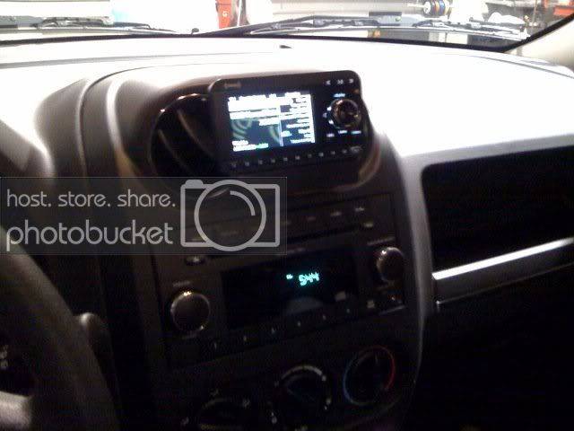

7).so after i used a new xm antenna and ran it the way it is suppose to be run, and then told the customer to buy a xm direct unit. this is the final result. I used a uni-bit and made a hole right beside the xm mount and ran the new wires threw it. it came out clean and thats how the customer wanted it in the first place.
