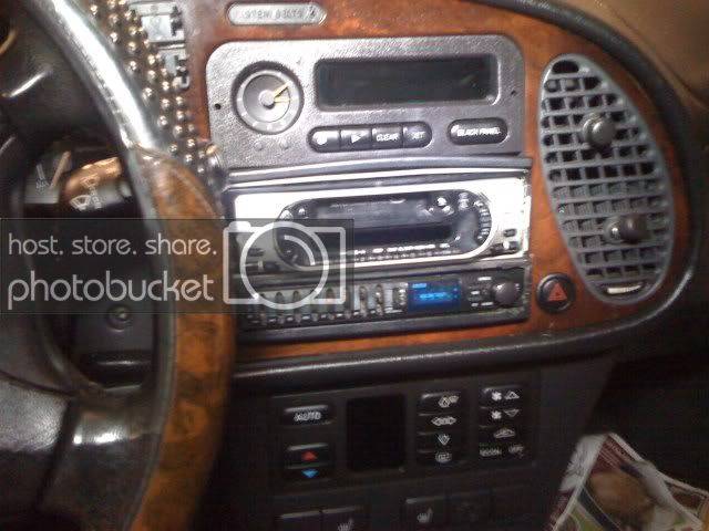

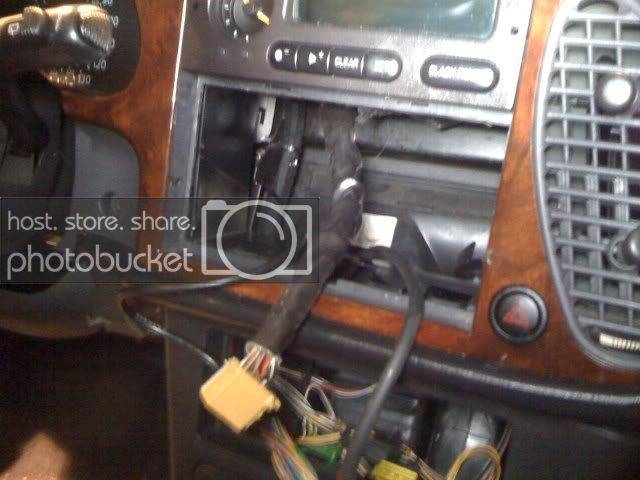

well fellas got another one in today a early 90's saab turbo, the customer just bough the car and said only one speaker worked........so i was like here we go again. the customer only wanted a pioneer deck installed but was in for alot more
Here is what i had to stat with
bad ford kit install and EQ install is never a good sign

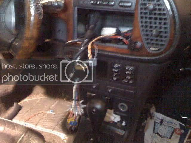

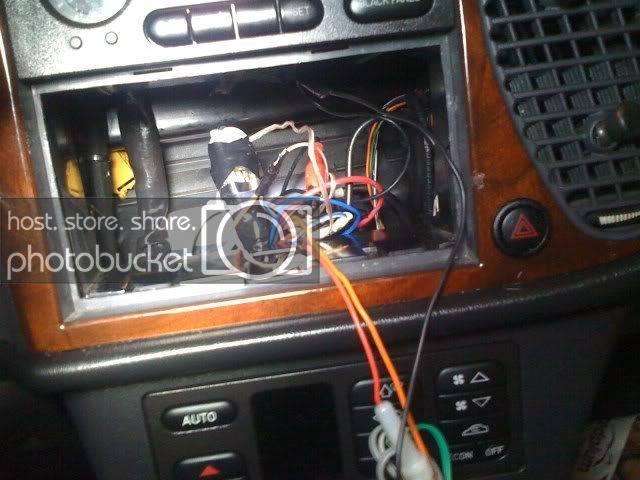

Once i pull the radio out, they didnt even use the volkswagon harness adapter?

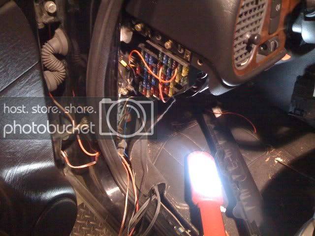

I guess they never though to look and find the factory amp and just catch the output that way so they drilled in the door and side skirts to run the speaker wire into the doors. instead of catching power at the harness they tapped off at the fuse box??
making some progress, and fished out the factory and untouched wiring harness from behind the dash

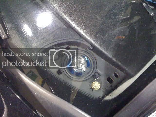

dash speakers werent even screwed in

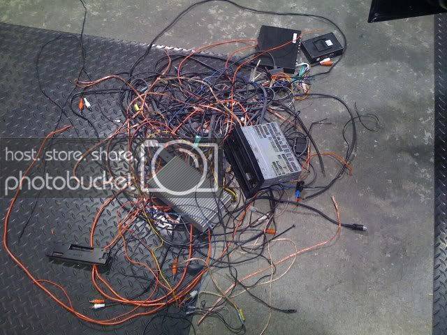

everything i had to take out including the factory amp

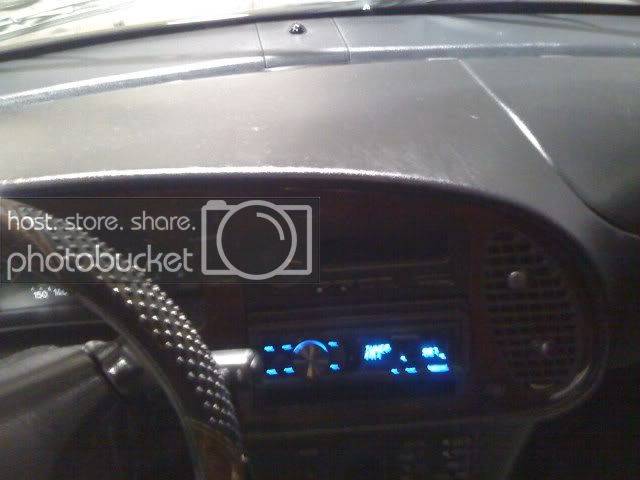

finished with a new kit in pioneer 5000
