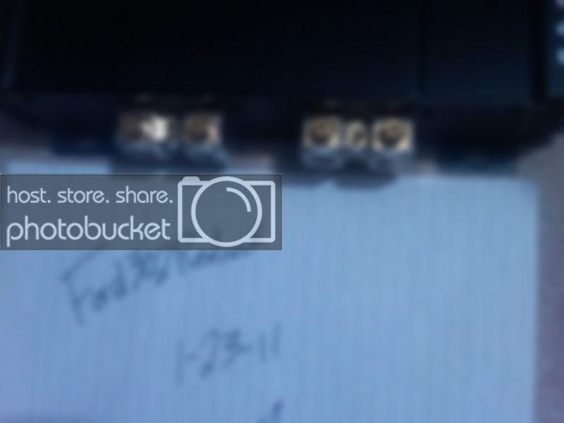

it uses 2 power/2ground just like any bigger amp with the same output.
you'll need two grounds from amp and 2 powers going to amp.
it'll look exactly like this
hope that clears it up.
