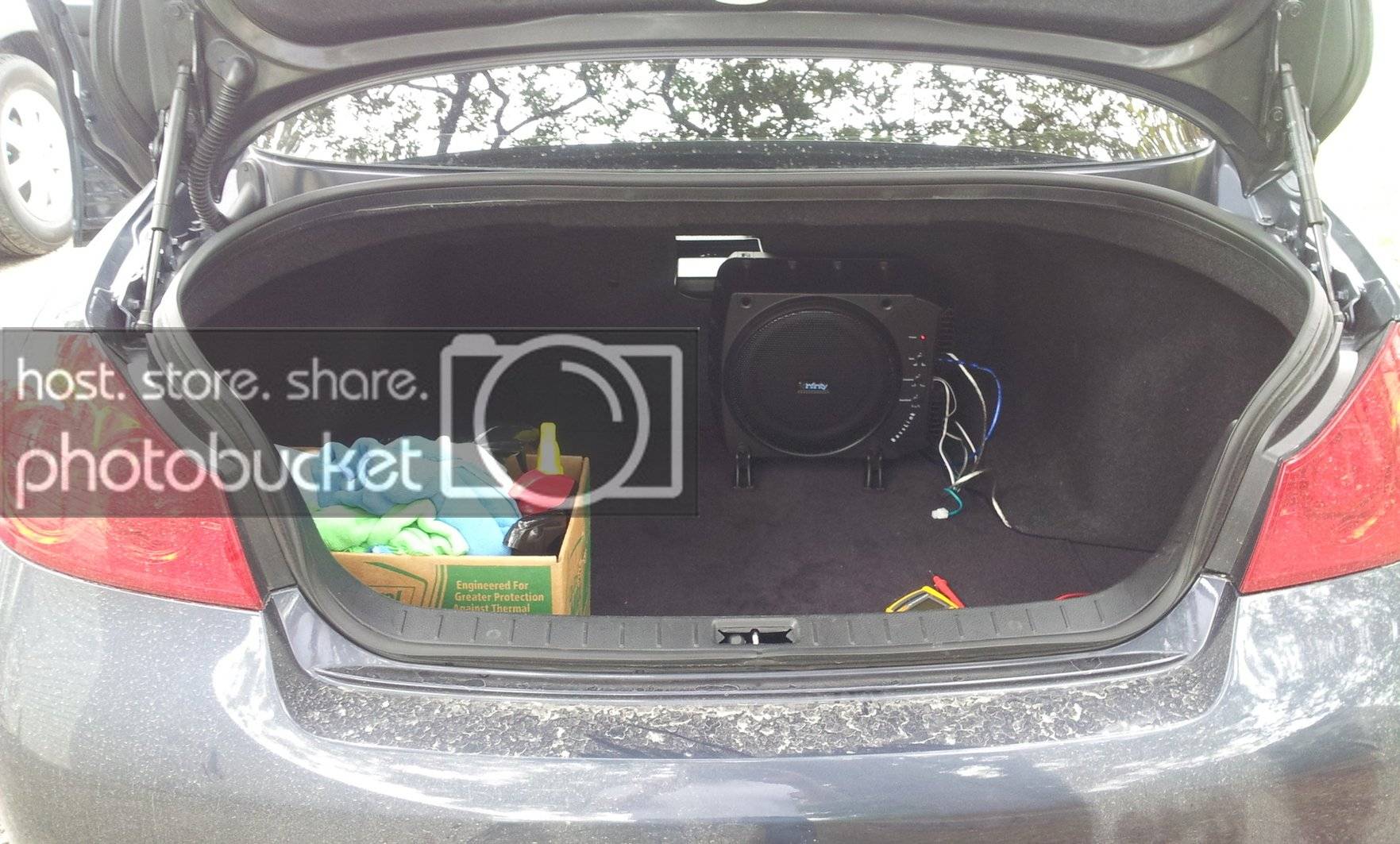

Here are a few pics. I need to clean up the wiring.

I put in passenger side corner but it didn't seem to make a difference as far as output. I messed with the gains, crossover, and phase. Seemed to be equal either way in this application.
Try putting it as far back as possible, facing the trunk, not the side panel. Honestly, the gain you will get out of it will probably not warrant the inconvenience you'd have from having it all the way in the back, but it might be worth a try just so you know how your car reacts to placement.
