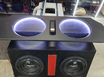

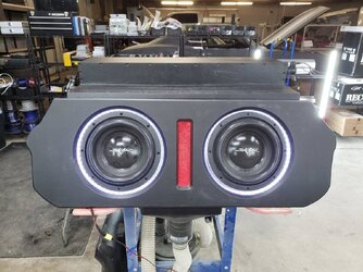

Really waiting on someone to chime in about mounting amps on top of the box..... I'm sure I can Fab up a nice looking amp rack out of MDF and acrylic and throw some lights in it but I'm also looking for someone to talk me out of mounting them on the box LOL..... and then point me in a direction on what in the hell to do with their big *****....

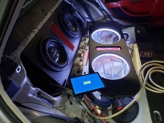

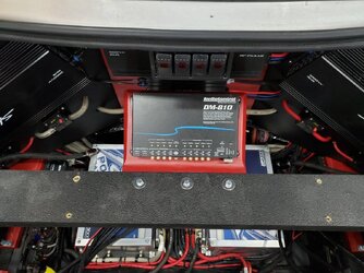

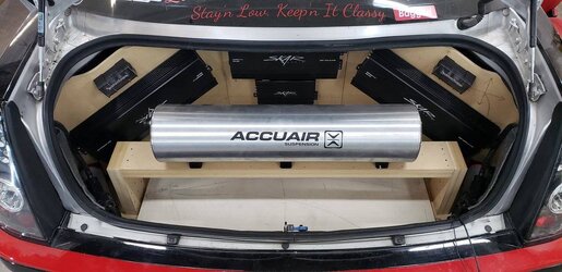

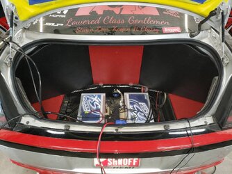

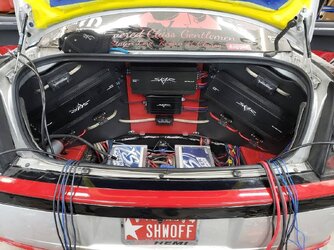

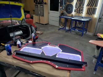

Late reply but thanks man......got more pictures and updates on my truck but it kind of got put on hold due to a customer coming in the shop with a Chrysler 300 show car and wanting to drop about 20 grand in audio equipment and fabrication so been busy with that but fixing to be done and starting on my truck build again.
Claiming you cant put something somewhere due to X reason is bosh. You can make a little shelf to elevate the components over top the AC ducts and retain them.

 you apparently dont know the dimensions of the amps im running and the space to work with....and your logic is hogshit...just because something "can" be done doesn't mean it "should" be done....but i appreciate the useless comment and spelling correction 👍👍

Want me to find a vid with a QC install where the amps are under the front seats? Itll be easy.
why yes!!  if you can find a video or pictures of 2 IA 4 channels and an IA Monoblock under the front seats of a 2500 Dodge im all for it.....but I wont hold my breath as doing that would either hinder seat movement, hinder the AC ducts in the floor under the seat, or at the least be an issue in the winter with heat from the seat warmers that definitely put out on these trucks.....
