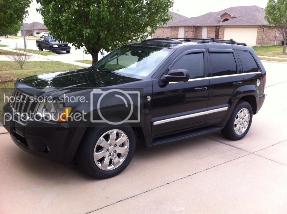

Ok so I really need you help deciding what I can do to my 09 jeep grand cherokee 5.7 with the RER radio/navi.
For now I can't afford a compeer able head unit so factory stay. There is a can bus line Inbetween the radio and factory boston acustics amp and after is like I said a amplified signal.
So at first I bought a universal line converter only to find out it can't take an amplified signal. So I bought a audio control lc2i ( haven't hooked it up yet I'm upgrading from 1-3 subs). The lc2i gives me a main out and sub so.......will this work Crutchfield said yes
I want to add a 5 channel my rear and dash speakers are full range but there are 6x9 mid bass in the front doors and the dash speakers are 3.5 components.
Hears the problem I don't want to replace with like the focal 3ways or anything because they only have a 6.5" woofer.........and the 8" drivers all need boxes for airspace. Is there an 8" that's free air or do I need to make custom door panels... I'm not to comfortable with that but my sub box will be fiberglass. I plan on running a pair of 8's off the 5 channel with the frequence higher like 150hz and the subs amp 150 and down.
What would y'all do?
Oh and I plan on havering 5 kenetic batteries with 1 up front and I would like the mech man 14v alt with a diode isolated but I'm unsure if I need a step down for the car electronics.
I see stats for amps and subs rated at 1w and 2 watts which is always a higher db .......who do I get that?
Does it make since to have 3 subs sealed vs 2 ported

For the batteries it's a jeep and needs a winch and kc lights and mabe back up lights. The truck is getting a roof rack and a 4" lift with 275 75 / 18's and an ac invertor bigger than it has maybe 3k-4k watts on system
Right now I have a mtx t812-22 but I've been really eyeing up dc audio level 4 12's in fact I might go with a dc5k 3. Lvl 4's and a 175.4 all matching.... I'm **** like that
