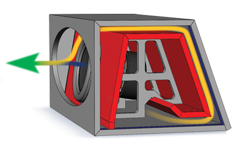

from my calculations, the HO112R-W7 has an internal volume around 2 cu.ft. and a tuning frequency around 34 Hz. the gross volume of the HO112R-W7 is about 5.8 cu. ft. for custom boxes, JL recommends a 36Hz tuning frequency and 1.75 cu. ft. internal volume for an f3 of 33Hz. my calculations do not account for any effects by the chamber-coupled port and i suspect JL engineers did a lot of testing to characterize the effect.
building your own enclosure can allow for lower tuning (below mfr recommendations), ditching the space-hogging chamber-coupled port (losing a coherent output), and allows for custom cosmetics.
the HO enclosure is well-built, well-braced, and optimized for the sub. The wedge shape is ideal acoustically and physically - increasing the surface area of the joints.
what HU? amp crossovers are more predictable. most set the LPF around 80Hz. Subsonic should be around 28Hz for a JL box (most are tuned 30-32Hz IIRC)
the only gain to building a new box would be a lower tuning frequency. the JL boxes are built very well. I have a dual 12W3 HO box sitting in my basement, nearly 13 years old now.
