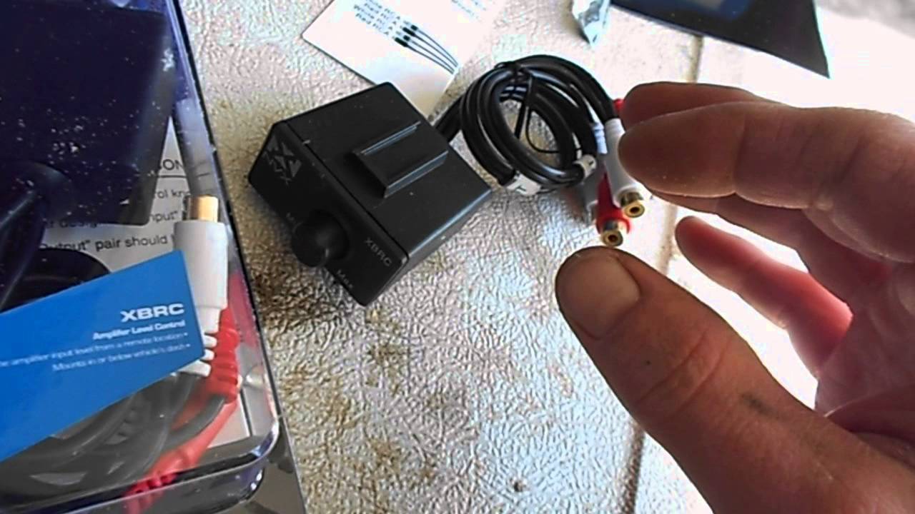

I use a level controller for my tweets. Used to use it for my sub amp. It's basically a passive component that can only lower your RCA voltage. It only cuts, not boosts. Set your gains with it maxed out. Then, you can turn the sub channels down when you want to.
This is what mine looks like:
$10 on sonicelectronix
