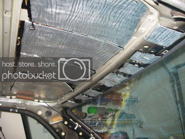

Time for me to continue on w/ the deadening and foaming here and there. I just toook out my headliner and misc. panels. It's going to be one hell of a night.

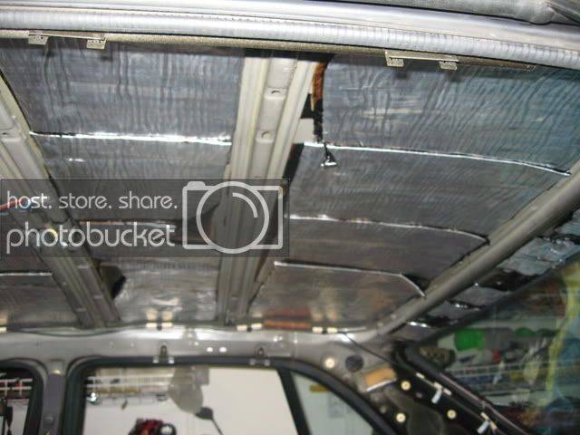

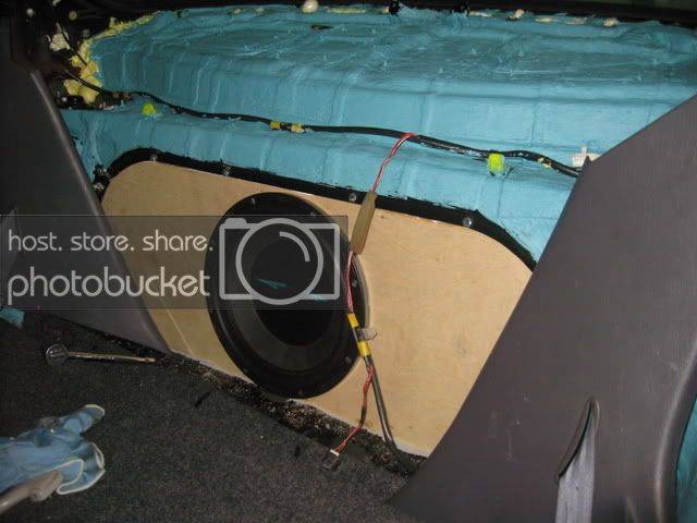

welp. here's a little progress pics. not much, though.

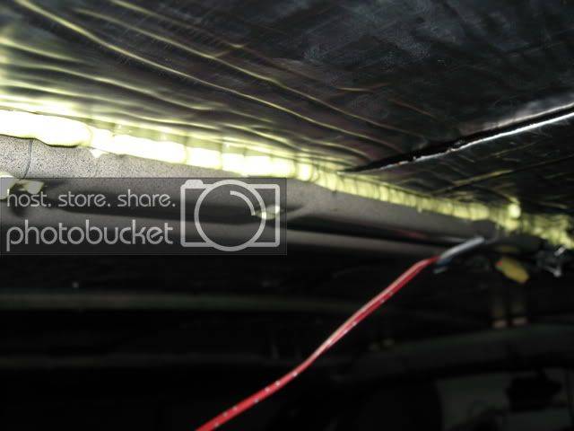

some old deadening from years ago. I cut out pieces that were loose and re-rolled over some bubbles... ( i did a crappy job)

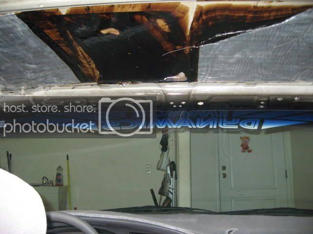

you can see a huge patch that just came off w/ the headliner.
the max again.

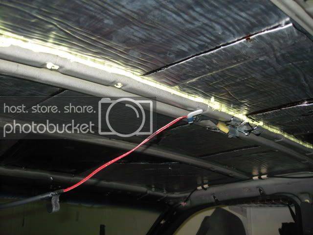

foaming away. using the window/door formula because it doesn't expand too much.
I'm not even sure if the foam will make a difference in these areas, but I have a few cans to spare, so what the hell. it might help.

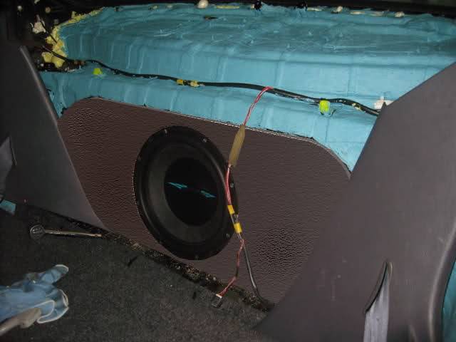

cool stuff man. all the other gurus beat me to it. i agree, dont bother making vents, your trunk is quite large.
i need to calculate the area in my hatch... i may have to make some vents. when i play low notes at loud volumes - its quite amazing, that 70lb panel hops around a bit.. i gotta make some reinforcements to that shit on the sides. some sort of rotating cuff to stop it from bouncing.

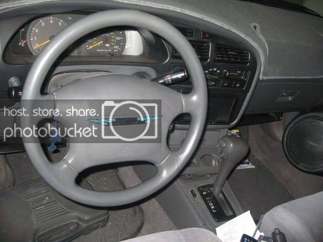

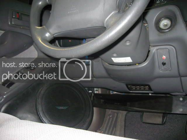

so more to satisfy those that must have pics. i'm one of them:)

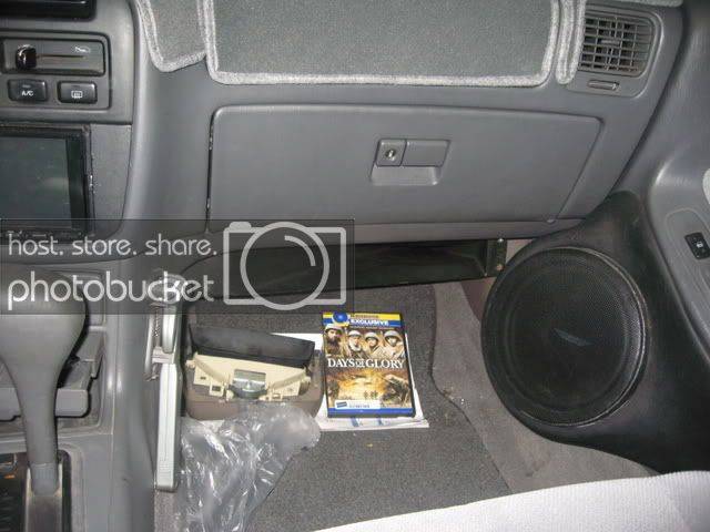

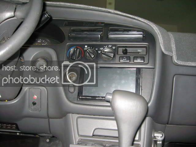

here's the rest of the system. The front stage:... w/ some mess laying around.
I installed these babies not long ago.
the source:

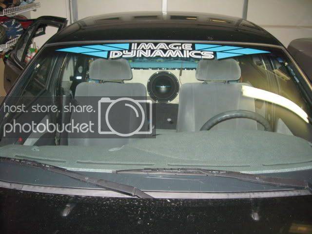

also as seen in the pics, i also have one of those dash mats. It really helped a lot with my stage height.
I use to tell people, " what do you mean my stage is not eye level... you just need to look down."

ill look into one of dem carpet thingays. i dont see how it should help really when we are dealing with horns. speaking of, im going to listen to some hotel california in my sennheisers so i can see where the insturments are located.
them carpet thingays helped a bunch. I took the advice of Jeremy Mullins (an ex ID employee). He told me that it was the most simple non-expensive way to bring up my soundstage. His reason was that sound was reflecting in between the windshield and my dash. Also, i remember reading somewhere that the sound from horns travel up the dash. Either way.... the shit works. almost the best ~$20 i spent.
