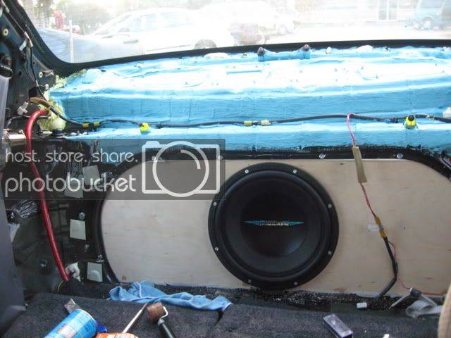

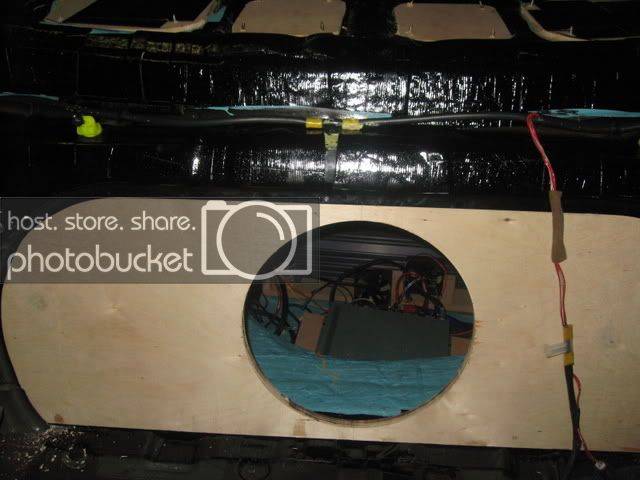

here's the baffle piece that the idmax will be mounted on.
a little mock up

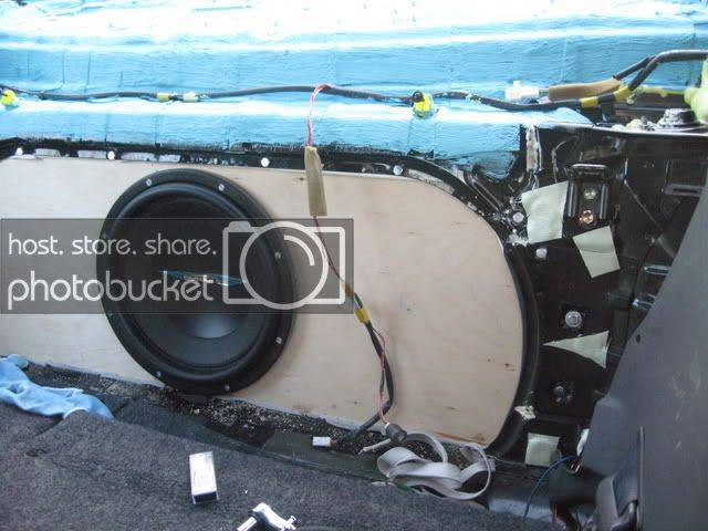

sub mounted and baffle bolted
there's some fat weather seal between the birch and metal. I was planning on using expanding foam but decided on weather seal so the board piece can be detached in near future.

Any sub can be used IB, it all depends on what the specs are to determine what kind of sound you will get. In SOME cases power handling goes down, in others, like maybe this case, the power handling may have increased.
IB setups can't really be beat for sq because of the mear fact that the sub isn't fighting with the trunk and other aspects of the car to get its musical notes heard in the cabin. IB is a great choice for anyone.

Hear a few and I guarantee you will change your mind, as long as they are correctly setup, btw how can you not be a fan of something you've never experienced?
Neither one of these are the case. IB may not be a great choice for some people and it is very possible to have better sound quality from other types of setups.

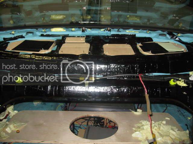

I had to reroute some wires so they'd be out of the way and out of the middle section, which is where the birch baffle for the sub will be.
Becareful to make it so the power wire can't move where you have it in between those brackets it could ground out.
nice observation. i was a little worried about that, too. I'll be sure to give the wire a little more slack between those brackets.

Does it matter if air is leaking to the outside of the car (magnet side)?
I not sure, but I wouldn't suggest it. I would think that the leakage may have some negative effect. My trunk had a vent that I sealed up just in case. maybe someone else can give you a better reply on that question.
Many would argue that allowing air to escape would be beneficial since it brings the alignment closer to a "true" infinite baffle setup rather than just a very large sealed box. I do believe Scott Buwalda (or someone of the sort) went so far as to cut a hole in the bottom of their trunk and covered it with gortex to intentially allow air to pass to the outside of the vehicle. And most who go IB are fond of trunk vents for this reason aswell.
