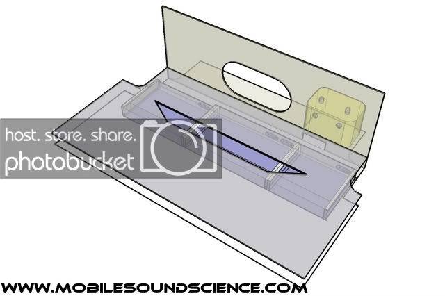

I believe I am set on what I want to do with my trunk. something simple. it should plain and effective. I also plan to put my spare tire back into the trunk.
-false wall w/ oval window to see the iDmax's booty and the yellow top will be hidden behind the wall, out of sight, unlike right now.
-false floor w/ image dynamics logo cutout w/ plexi and ID logo on plexi showing amps behind it. Or not plexi and just leave the cutout. not sure. It should be able to raise w/ the help of hinges (between false wall and amps). I'll have to remove the false floor covers before taking out my spare though, if I have to.
What do you guys think?
Won't the false wall act like a really crappy ported box, since the air has room to bounce around with only a small hole to escape into the trunk? Other than that possible problem, I like it
yea man, that beauty panel wall thing should cause an effect on the speaker, im not sure if it would be strong or weak, or whatever. but with that small of an opening it would be something.
maybe you could make the hole bigger... just enough to cover the battery up. know what i mean?
hmmmm maybe i'll change the oval window into a rectangle and have it reach all the way to the baffle. Something like a display box. Or would it be okay that I make the oval much bigger? It should be approx 19" wide x 11" high.
....now I'm thinking I should lose that false wall all together... that would take more to make it look nice though.
That's what I am doing in the ib install I'm working on now. Which also happens to be in a camry. My plan is to build an open ended enclosure around the basket of the sub , just to dress it up. Then a gigantic oval cutout the same size as this
to mimic the cutout around that big bastage that will be mounted in the false floor. Then make an inset trim panel to cover the cutout with grill cloth to match the trunk carpet or as close to it as we can get. //content.invisioncic.com/y282845/emoticons/smile.gif.1ebc41e1811405b213edfc4622c41e27.gif
You could always make a beauty panel to bolt directly to the baffle, then build a separate battery box. Or maybe hide the battery in the false floor compartment? Could replace the yellowtop with something thinner like an NSB90 (I believe those are dry cell)
