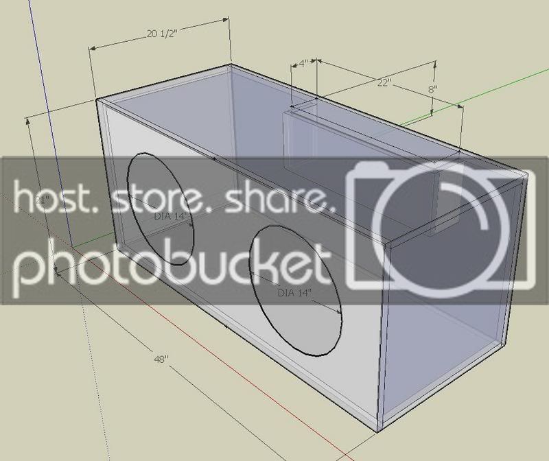

B bluelceii 10+ year member SH0WTIME 485 0 Alabama Jul 1, 2007 #4 48x21x19 (W x H x D) 31Hz for 2 BL 15s, sub up port back

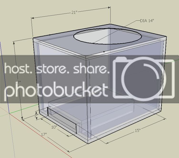

Thetalkingshoe 10+ year member Oh hay there 709 0 Chadds Ford, PA Jul 1, 2007 #5 3.5 cubes @ 28HZ for a 15" FIQ Make it so sub fires up and the port is in the back.
OP cbrrocketrdr 10+ year member HareFstrVdub 735 0 Scranton, PA Jul 1, 2007 Thread Starter #6 here ya go... 17" H 17" W 21" L 3.512ft^3 @ 28Hz Vent: 10" W 2" H 15" Deep

OP cbrrocketrdr 10+ year member HareFstrVdub 735 0 Scranton, PA Jul 1, 2007 Thread Starter #13 ok blue sry i was in a hurry bc im tired as **** so your 19 is now 21.5 overall: 21" H 48" W 21.5" D vent: 4"x22"x8"deep tuned for 31Hz just flip the box over in your head from what the pic looks like lol 9.183ft^3 btw
