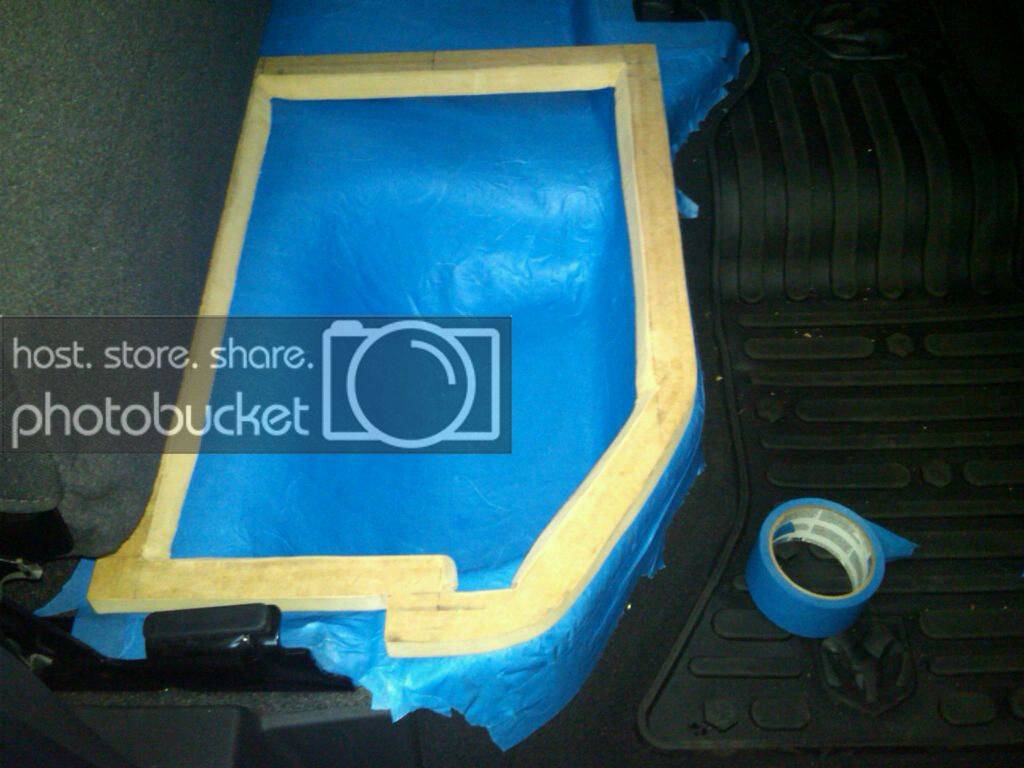

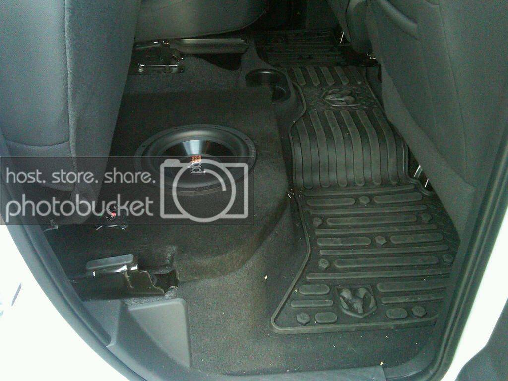

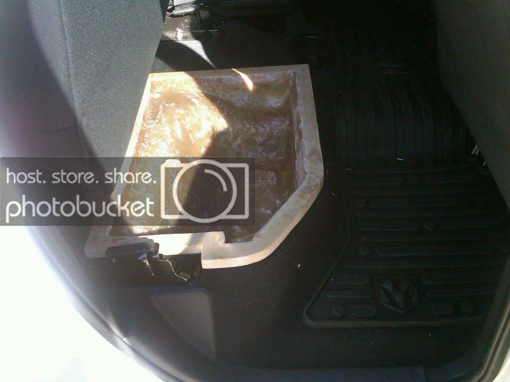

I own a 2011 Ram 1500 quad cab. Decided to add a sub to the factory system going with a budget type deal. So, I built a fiberglass/wood top enclosure that fits under the back passenger seat. I Went with a Powerbass L-104D sub, and an Alpine MRX-M50 (500 watts @ 2ohm). Factory head unit, Audiocontrol LC2i line converter.

The system sounds ok, but I'm just not getting the hard thump I was expecting. It also doesn't seem like the sub can be turned up too far without sounding, maybe distorted? To a certain point in volume on the sub, it sounds clean, turn up the auxilary gain knob any more and the sub sounds like it knocks or smacks something. Hard to describe.
I honestly don't know the exact volume of the enclosure. I just went off what others int he Ram community were doing, but with different brand varieties of subs. They all seem to think it sounds great.
Anyways, just looking for advice on what to do, where to go back and make adjustments, etc. This is my first build/install beyond just a head unit and speakers in past vehicles.

ft³ = L * 0.035315
Fill the enclosure with water. Using a 2 liter soda bottle. Fill up the bottle with water. Dump it into the enclosure. When its full. You should know how many liters you put in. Take those liters and use that equation to find out cuft.

From just the looks you are over the .75cu.ft sealed recommended for this sub. This is why its bottoming out. And I have used packing peanuts to calculate internal volume as well. Find a cardboard box with internal specs of 12x12x12. Fill it full of peanuts and pour it into the enclosure. Thats 1cu.ft. I am betting this enclosure is 1-1.25cu.ft
You could probably change to a 12 and have more than enough room sealed.
