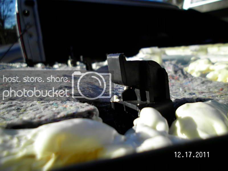

My door panel is pretty flimsy too. I ended up using some expanding foam to help stiffen it up. It actually worked really well. My door panel is made from 3 different pieces that are sonic welded together and flex really good when the air would start moving. It really irritated me bro! I tried a couple things, including deadener, but ultimately the thing that worked was expanding foam. Here is a pic:
The foam is pretty stiff, but it's still flexible. Since it's not a solid structure, it doesn't rattle either. After it's solidified, it's easy to trim to the contours you need too. But the biggest plus, is it's cheap!!
