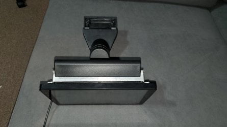

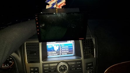

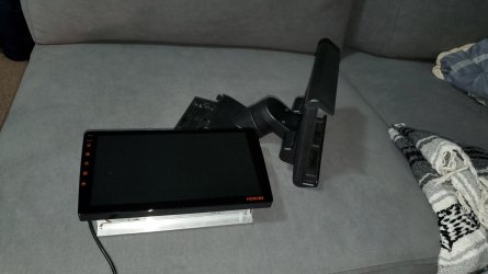

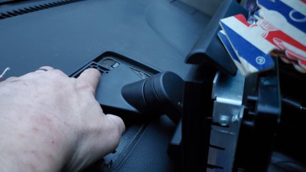

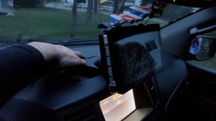

I bought an android HU not too long ago(had other plans for it.) I also just found an unused tablet mount for our oliptical.. I had some small aluminum angle laying around and made some flanges on top and bottom of Android H.U. for mount to be able to attach & hold Android H.U.
I removed the center dash speaker & grill. I used some 5/16 thick HDPE black plastic & cut it to fit perfectly in void for grill & speaker, used original holes that mounted speaker down and ran a 5/16 tap through them to fasten down HDPE sheet.
Ran a 9 conductor multi wire down into dash behind bose HU underneath shifter & center console to a Wago terminal block mounted underneath driver seat.
I already had dummy switches mounted just underneath steering column for led lights, on board air & air ride controls. Have two unused toggles 1 for Ign wire to feed power to bose & 1 for the remote wire feed to new Android H.U.(Not 100% on that yet) just wanna make sure that I have to use turn the corresponding toggle switch for device I need...bose strictly for navi, back up cam if needed & rear dvd player for my 2 boys on long travel hockey tournament trips
And the android for music, and upfront movies/entertainment, hopefully no more issues!!!!! 20230331_194311.jpg
