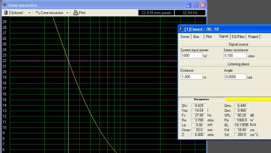

I beg to differ. For IB, Xmax is important if you want to achieve output at lower frequencies. Case in point, take the IXL-10 for example. It has a higher than average Xmax for car audio use but based on the bottom picture will reach Xmax long before it reached Fs with 1000 watts.
The IXL-10 might be worth looking at if someone wished to use multiples, but I would still lean towards a higher Q driver.
