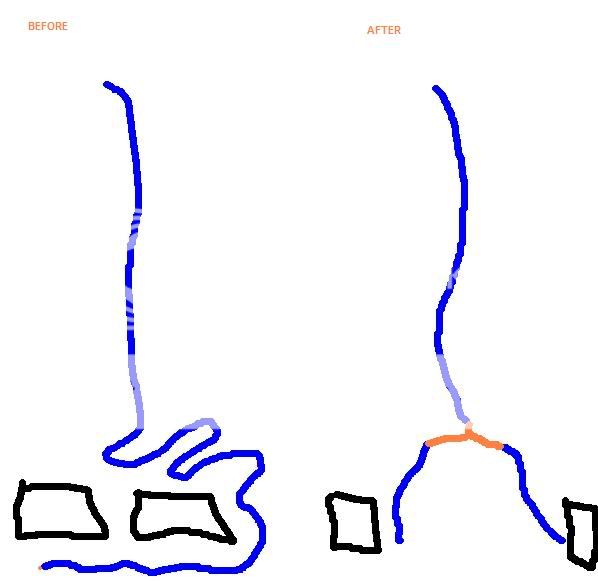

well when you get a chance, can you explain your remote wire, because when i read earlier, it sound like you spliced one wire down the center of it, to make it into two wires. if so you should redo your remote wire, and use a relay, or easier run it to a butt connector, and run two wires out of the other end of the connector. get some sleep, we'll help you tomarrow
that's what i did with the remote, cut all the extra off, then cut the extra into two, so i could have one going to each amp, then i spliced them both to the original remote..

ya's its really hard to phuck it up. Do this, get a really long run of say like 20AWG, and then hook one side of it up to ur battery postive, and the other side to the remote in on the amp. The amp should turn on at this point. If it didn't its not the remote line.
I'm messing with painting cars right now. Lotta stuff to learn. All that different types of paint, mix rations. Woh! //content.invisioncic.com/y282845/emoticons/tongue.gif.6130eb82179565f6db8d26d6001dcd24.gif
Or take a really short run (4") of say like 20AWG, and then hook one side to the power input on your amp and the other side to the remote input and watch what happens. Make sure to disconnect the remote wire going to your h/u first though. If you want to do it the right way then buy a meter.
