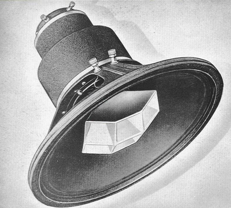

james you should coax mount ur horns to ur mids i think that'll give u the best sound.
Altec already tried that //content.invisioncic.com/y282845/emoticons/biggrin.gif.d71a5d36fcbab170f2364c9f2e3946cb.gif
They actually sound pretty good, when bi-amped //content.invisioncic.com/y282845/emoticons/smile.gif.1ebc41e1811405b213edfc4622c41e27.gif
IIRC, Ive seen any even older version of the same idea.
