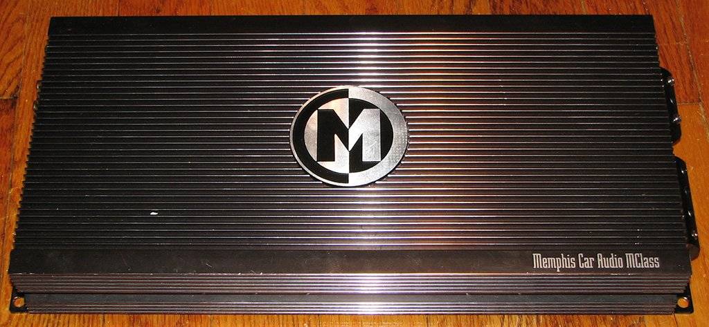

i need to know the rms and max settings on my memphis amp
Looks like a 16-ST1000D to me.
(in the hole on the back side - you should see two 40-amp fuses), but to be certain, you could take the back plate off and look for the identification on the PCB.
If this is the case:
300 watts @ 4 ohms
600 watts@ 2 ohms
1100 watts @ 1 Ohm
