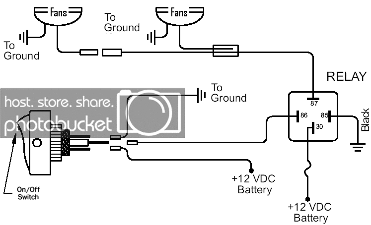

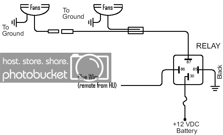

You can use the remote to power an automotive relay. Here is an example for wiring extra lights:
In the diagram, the green wire would be your remote wire, the +12vdc can come from your amp, the ground can come from your amp, and the red wire would power the fans.

Are you saying I can run 2 sets of lights and 8 small fans off of one relay? Do I need 2 different relays for 2 on/off switches? I just want the fans to come on with the system, but I think I have the fan part figured out. I'm saying when I turn that switch off, will the fans still be on with the system?
Also the amount off stuff you can run off the relay depends on what the relay is rated. The relay is called an 'automotive relay' and is pretty common you should not have a hard time finding one. The relay will have the max current stamped on it, I think most are around 10amps which will power many pc fans.
Here are some better pics. This one is if you want the fans to turn on and off with the amp.
This is if you want to use your own switch:
I'm running some led's right now on a switch without a relay. I understand using a relay for the fans, but do I really need one for the led bars/strips? I think the way I hooked my led's up is, all the black to the -batt post and the red from the +batt post to one side of the switch and the red from all the led's hooked together to the other side of the switch. I know they make different switches. Does the one in the diagram have 3 connections or 2 on the back? Thanks for the diagrams!
the ground lead on the switch, ie. the 3rd connector, is there to provide a ground for the LED inside the switch indicating on/off position of the switch...
it'll work fine with a switch with two leads as well, ie. a switch without an LED indicator...
