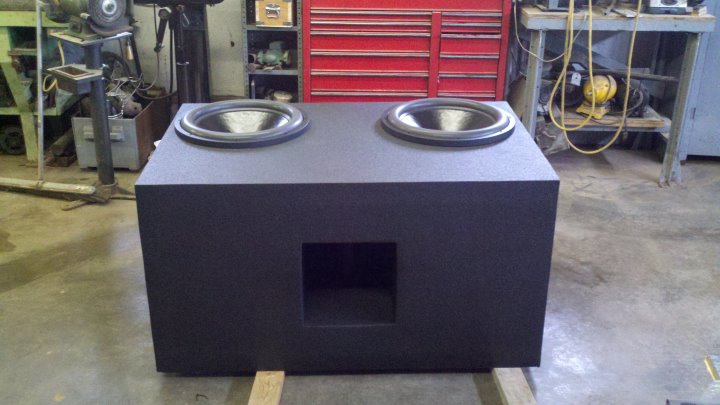

i need a box design please
Gave it a shot for practice...
4.5 Cubes per chamber, tuned to 32hz with 3 inch slot ports. Designed for dual 3/4" Baffle.
No clue if it's right or not, you'll be better off with a pro's design.
awesome design rendering but airspace is a huge constraint seeing as this box is sized more along the lines of 15 territory.
op u might need to run 15s or give up more height to gain airspace
Thanks.
I don't think it will work either, 4.5 cubes is kind of a strange measurement, it's too much for most 15's and not enough for almost any 18.
You'll need to figure out what you want to do, but I wouldn't run 18's unless you can find at least another cubic foot per side.
can you sketch the exact same box in the pic but with my measurements W43 x D30 x H22 tuned at 32Hz???
Done.
Comes out to 10.8 Cubes Net @ 32hz, 10 inch square port, 16 inches deep. I added vertical bracing, but lateral would probably be needed as well. Once again, double 3/4" baffle.
Done.
sweet bro thanks but FI recommends 6 cubic feet per sub right ????
I believe the minimum they have posted it 5 per, but even at 6 I think you would still be mechanically limiting the sub, 7-7.5 would probably be optimal.
