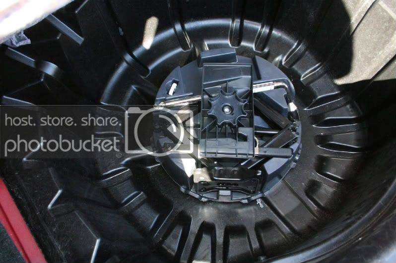

Only thing that vibrates is the spare tire well... it's made out of plastic.
Nothing else rattles...
