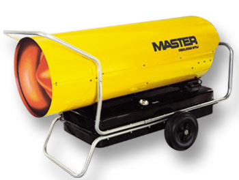

The torpedo type (jet engine) propane heaters crap out after about 2-3 years of actual use. I've had the good ones and the cheap ones, same thing, 2-3 years. The thermostat safety valve goes bad and the flame won't stay lit.
Get yourself one of the heaters that mounts to the top of the tank or this type below.... I've had this for 2-3 years now and there is no safety valve to fail on this unit. There's no fan or electricity needed on this type, no noise.
