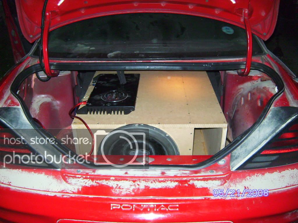

alright so i've got a design, the enclosure calc says it'd be at 34.75 hz. would that be alright?
and i get 5.64+ .331= 5.971 cu ft for box size after port? with port being 1.127 cu ft, numbers sound about right? and i finally replaced the ole ab dx 15 for a Audiopipe TXX-SPL15. i've been lookin everywhere for a box spec for this sub but no luck so far, not sure if this box design would go well for it or not.

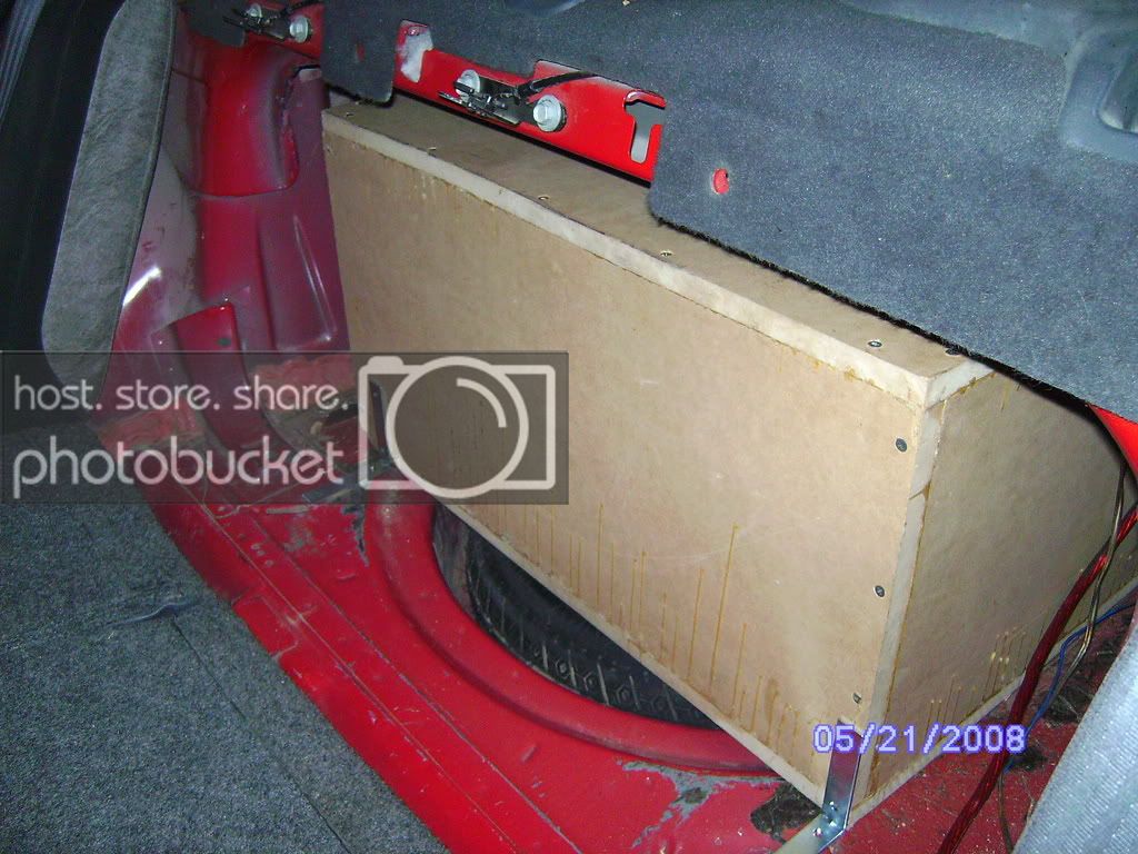

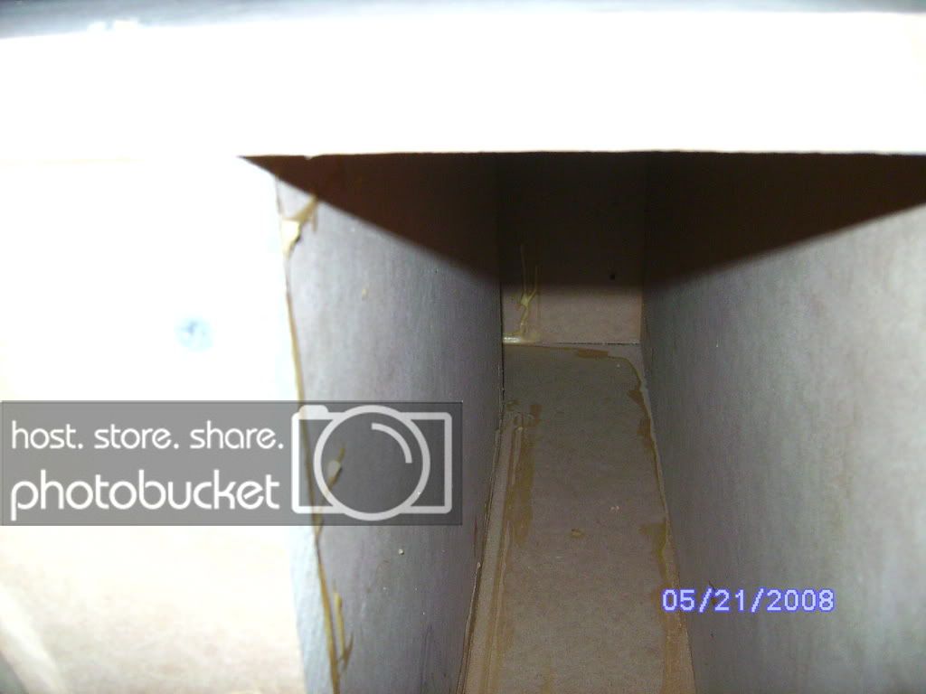

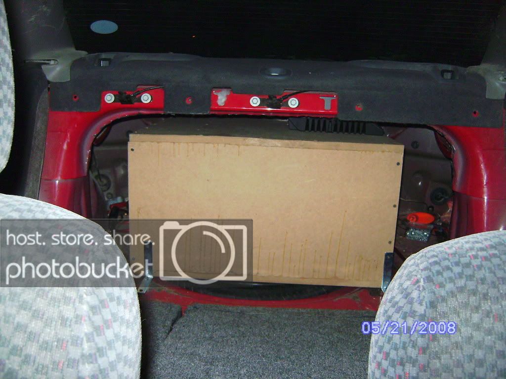

alright the new box is finally done, spent a couple hours on it tonight.
only took a minute or two with a crowbar to get the old box out lol.
i went to home depot today and got some mdf, and i actually used wood glue this time. ended up going smaller than at first, tuned to 35 hz. havn't had time to test it didn't wanna wake the neighbors.
