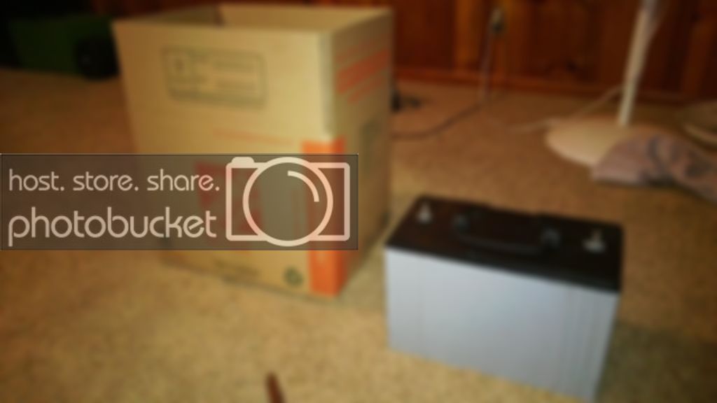

We are packing a Deka 8a31 today

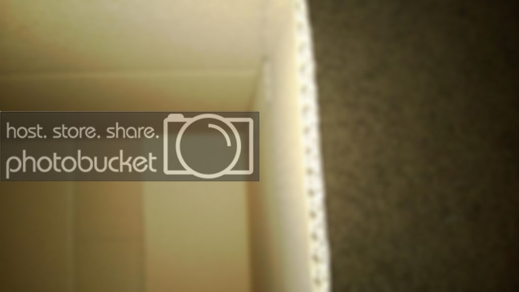

First thing is get a double thick cardboard box. Home Depot sells them for $1.50 may be different at your local store

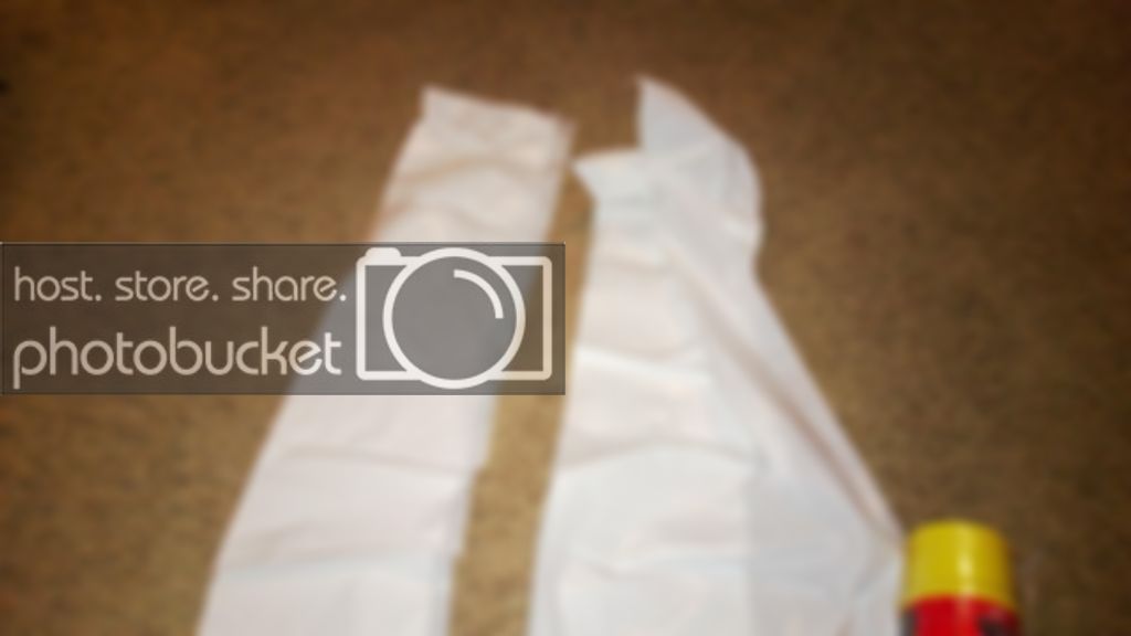

Next you will need some thick trash bags.

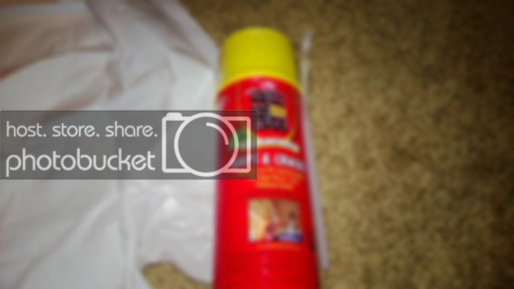

Also will need some Great stuff expanding foam. The red can works the best for most items

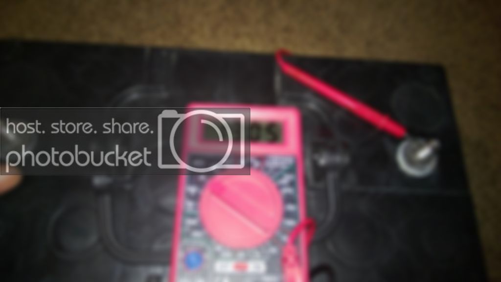

Always check the voltage of the battery before you start to pack it

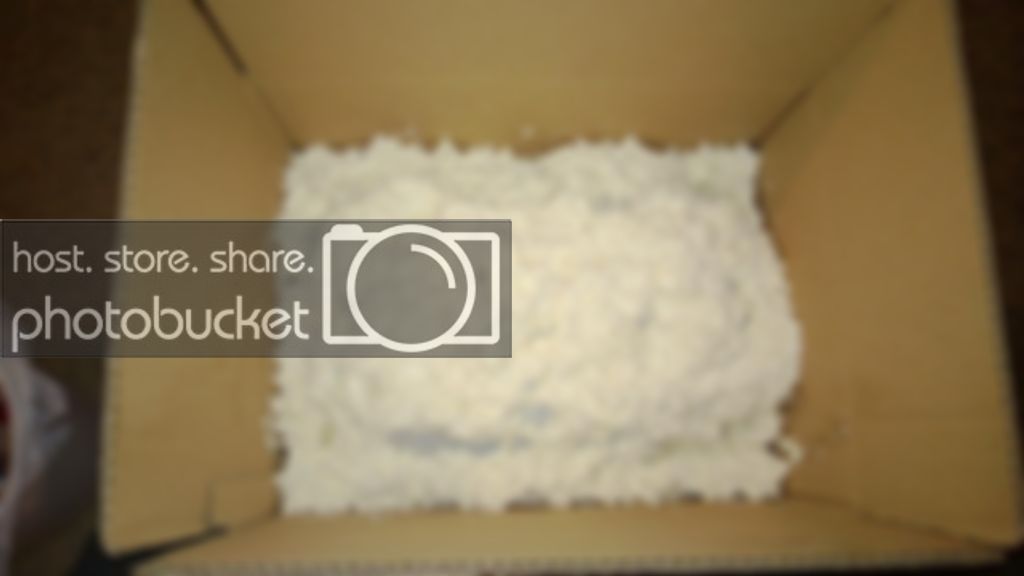

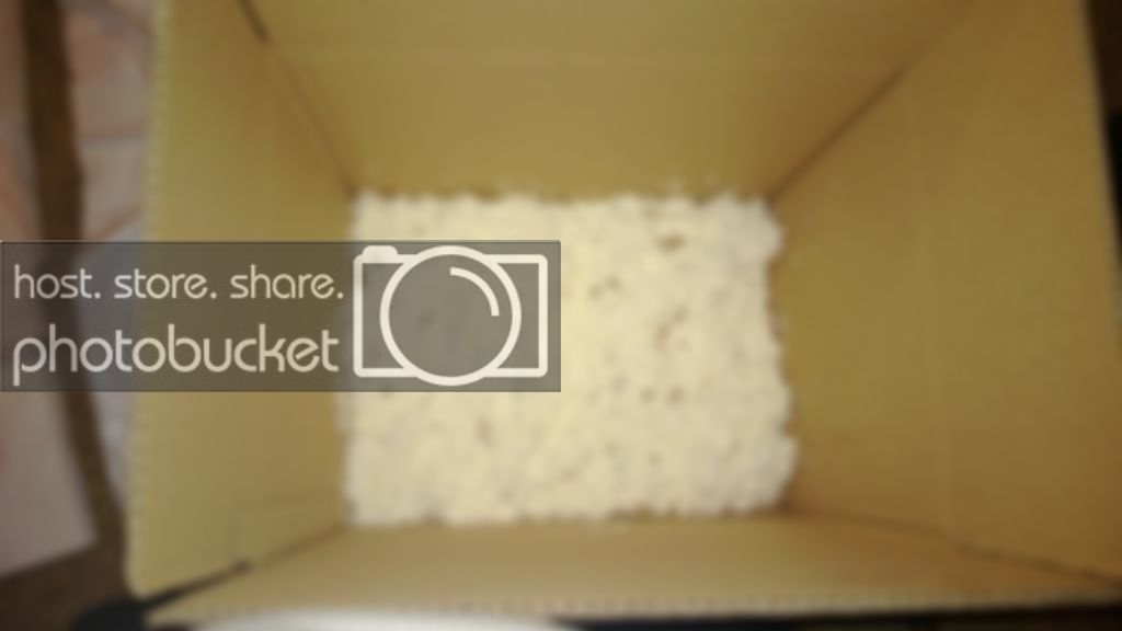

Take the spray foam and line the bottom of the box with it.

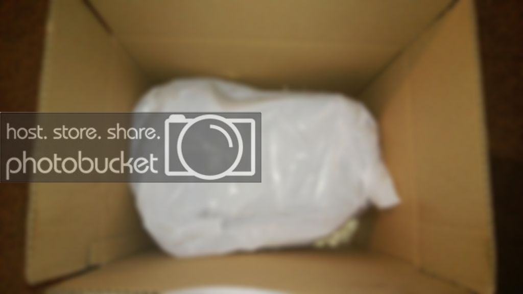

Wrap the battery in the trash bags making sure you cover the battery completely. I use two sometimes three depending on the bags thickness. Well the foam is still wet place the bagged battery in the box
Next finish spraying the can of Foam on the sides and the top of the battery

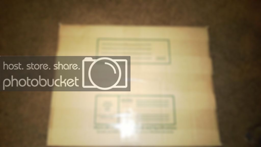

Last seal the box up so that the foam will expand around the battery making it very secure once it dries..
