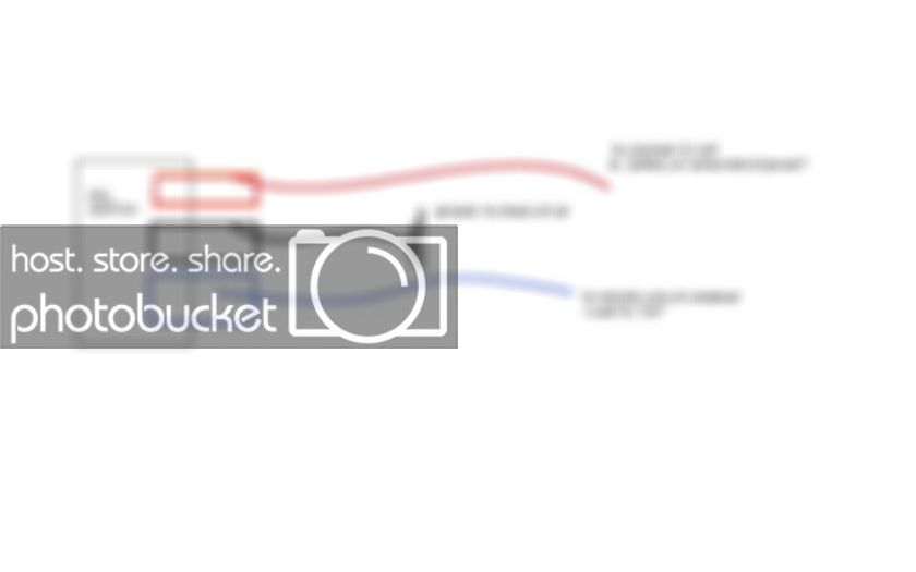

if i do this id shut off both my amps (full range/mono) i just want the kill switch for one of the amps not both.
the only way to make this work is to run two seperate remote wires....one for the highs amp...and one for the bass amp
yeah i already did that
. i split my "main remote" into two.
one for speakers
one for subs.
so now what? i tap into my sub remote wire, right?
like this:
