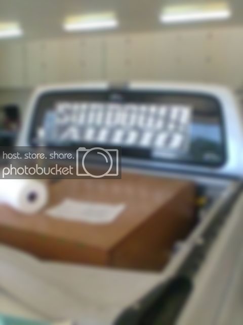

I wouldn't suggest using bedliner of any type unless you resin the entire outside of the box. The bed liner crap doesn't water proof so over time your box will turn into sawdust.
My boxes have all looked like this:
I covered mine in fiberglass resin...bondo is the company. You can get it at autozone, pep boys or whatever. All you'll need is 1 quart. I had a friend with an air chisel and grinder do mine. If you can find one of those pnemuatic scissors (don't know what they're actually called) that would work the best.
