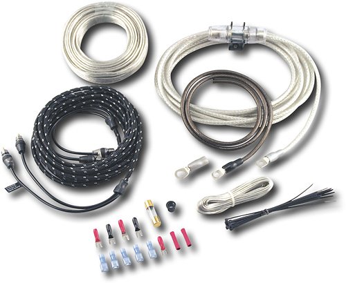

How many amp kits would I need? does RCA's come with the kit? Should I just get this, and this will get the job done for everything?
Rockford Fosgate 4-Gauge 800W Car Amp Power Kit
Model: CP4POS-06

I'd just get 3 sets of standard RCA's. I'd run 4-ga with a inline fuse (guessing 140AMP) from the battery into a distro block (unfused block). Then, run 2 8ga out. 1 to component and, one to sub amp. Run the grounds. Done. As for the REM wire you can run a single one from the HU and loop it from amp to amp.

Ok, here's what I'm going to order:
1 of
http://www.knukonceptz.com/productDetail.cfm?prodID=KOL-AK44
1 of
http://www.knukonceptz.com/productDetail.cfm?prodID=BC-1448
2 of
http://www.knukonceptz.com/productDetail.cfm?prodID=KLA-5M
