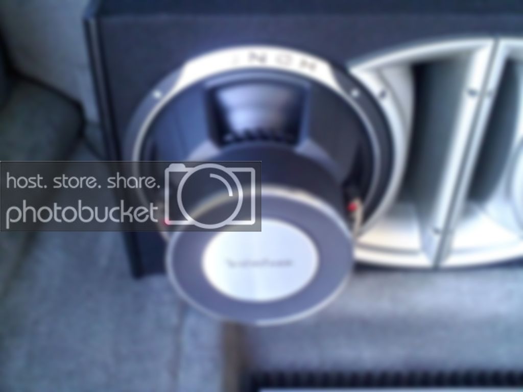

Heres how you do it, how ever you had it wired right now before inverting the sub keep it that way, mount the sub inverted and just swap the - and + wires on the inverted sub and you should be done. //content.invisioncic.com/y282845/emoticons/smile.gif.1ebc41e1811405b213edfc4622c41e27.gif

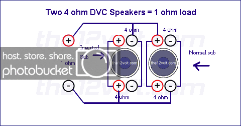

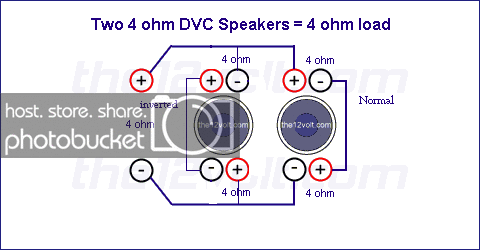

Here, wire it like this to a 1 Ohm load (if your amp can handle it, I didnt check)

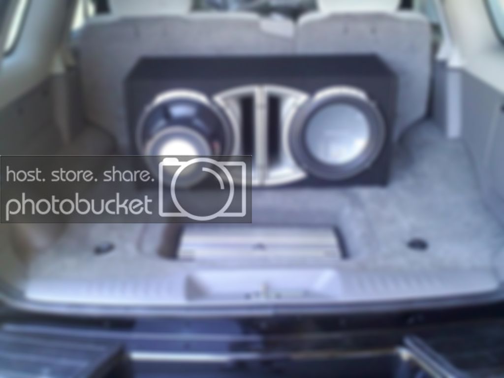

I don't mind it, it looks different. I think with a nice FG box that had some nice curves and went the entire width would look badass like that. Just my $0.02.
