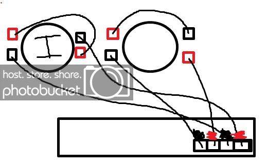

so would this be right??
left sub is inverted.. i know the pic sucks but i just did a quick 2 min sketch...
I assume your trying to wire it to 1ohm right?
You need to leave the wiring on the subs alone, they should be identical. But at the amplifier, switch the leads for the inverted sub.
EDIT: and no that pic isn't right...that left sub is wayy off
