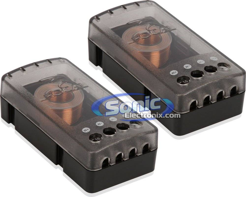

this... you need the crossovers. do a google image search and you will see what they look like. it has a input + &- (from amp) and a woofer output and a tweeter output. there is one of these for the left and one for the right speakers.
you are missing these

I know what crossovers are... I'm just not sure how to hook up my speakers to a 4 channel because they somehow don't use one. That is a selling point of the "Integration" line of speakers from Focal.
ok buddy - you are right.
Your speakers have built in 6db crossovers on them.
What is it you want to do? Me personally I would run the tweeters from 2 channels of the 4 channel amp and the mid woofers on the other 2 channels.
