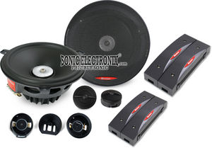

I am just curious to what everyone feels safe, pushing through their components, as I have had a few members on here suggest I bridge my 4 channel amp, for my door speakers. I am very weary of this idea because my components have a peak power rating of 220w per side, bridged my amp would be putting out 200w x2 rms.
Isn’t that kind of risky? These are Boston SL60S 80w rms per side. My JL jx400/4D does 70w rmsx4@4ohm...wouldn’t that be safer? Or would it be worth bridging? I really don’t want to cook the Boston’s.

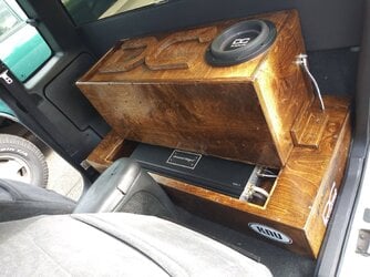

This guy knows what he's talking about. My amp was benched to do over 200 rms into 2 ohms and according to what it's supposed to do on paper, 175x4. I got some Polk comps that handle 125 rms. the trick is setting the gain properly with a clean signal and limiting the amps output to match the speakers rms output.

Well now that I’ve been doing some research, I’m thinking about biamping, instead of bridging the amp. The stress would be less on the amp, and the sound quality is supposed to be better. Since the Boston x overs are setup for biamp, I may as well. The hard part is gonna be finding another blank in the plug big enough to drill out, to get another speaker wire through the drivers door, and then I’ll just run 2 to the passenger door.
I have 50” of speaker wire coming on Saturday, but now, that probably isn’t gonna be enough lol.

What do you think about biamping them?
If I ran say, channels 1 and 3 to one crossover, and channels 2 and 4 to the other. That would be 70w to each driver at a 4ohm load. If I set the gains right, I should have a really good front stage, without raising the amps normal load.

I mean, look at how many amps ive had to run to the front stage in the truck to try to keep up with , 4 sub on 4 sub amps (added one amp per sub to keep running cooler and a little cleaner)/I have an amp on every speaker/or pair.No HU powered speakers.Im changing things up in a bit
