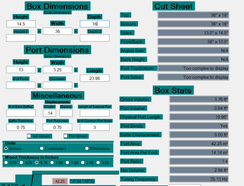

Those 12W7 work well in 4ths, in your case for a single 12 it wouldn't even be too huge. Just pay attention to the overall size and it ain't too bad. Below is a 1.5:1 47hz tuned 4th for a 12w7ae-3 that has 24in2^ft of port on the vented side. The response and extension looks great with low delay and nice output.
