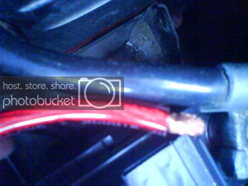

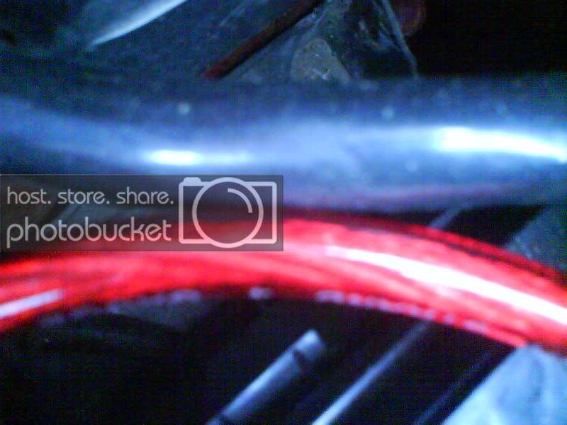

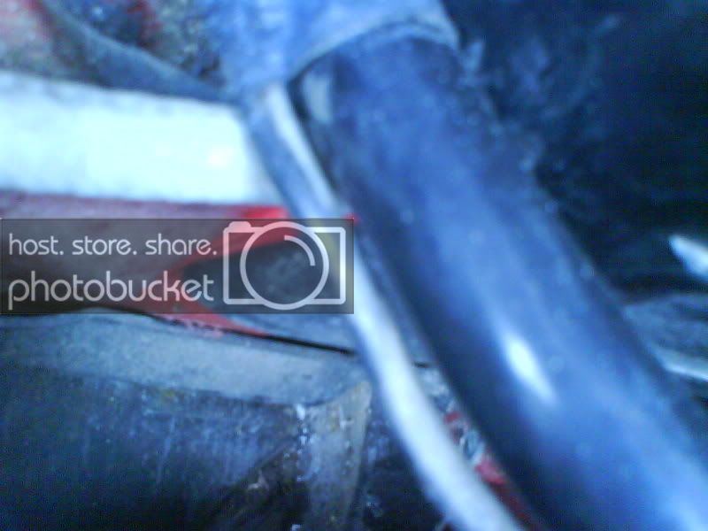

Well.. My car is stock everything.. Here is a pic comparing the stock wire to some 4g wire... BUT as you see in one of the pics, there is a really small wire that runs with the large wire.. What is this wire?
