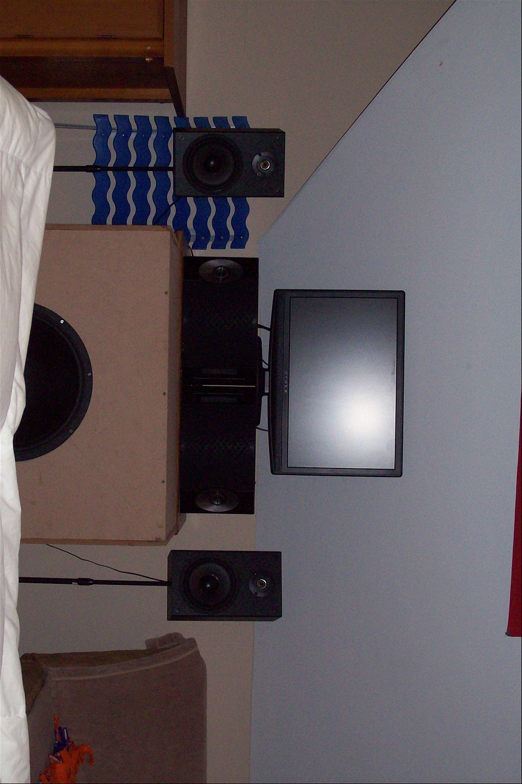

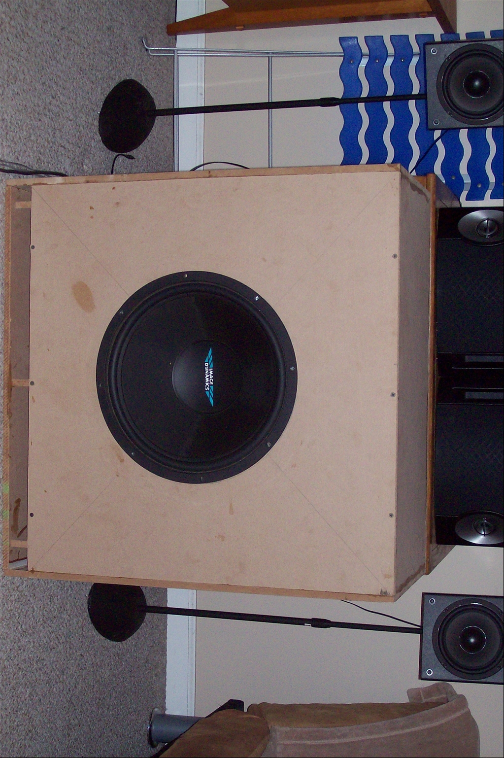

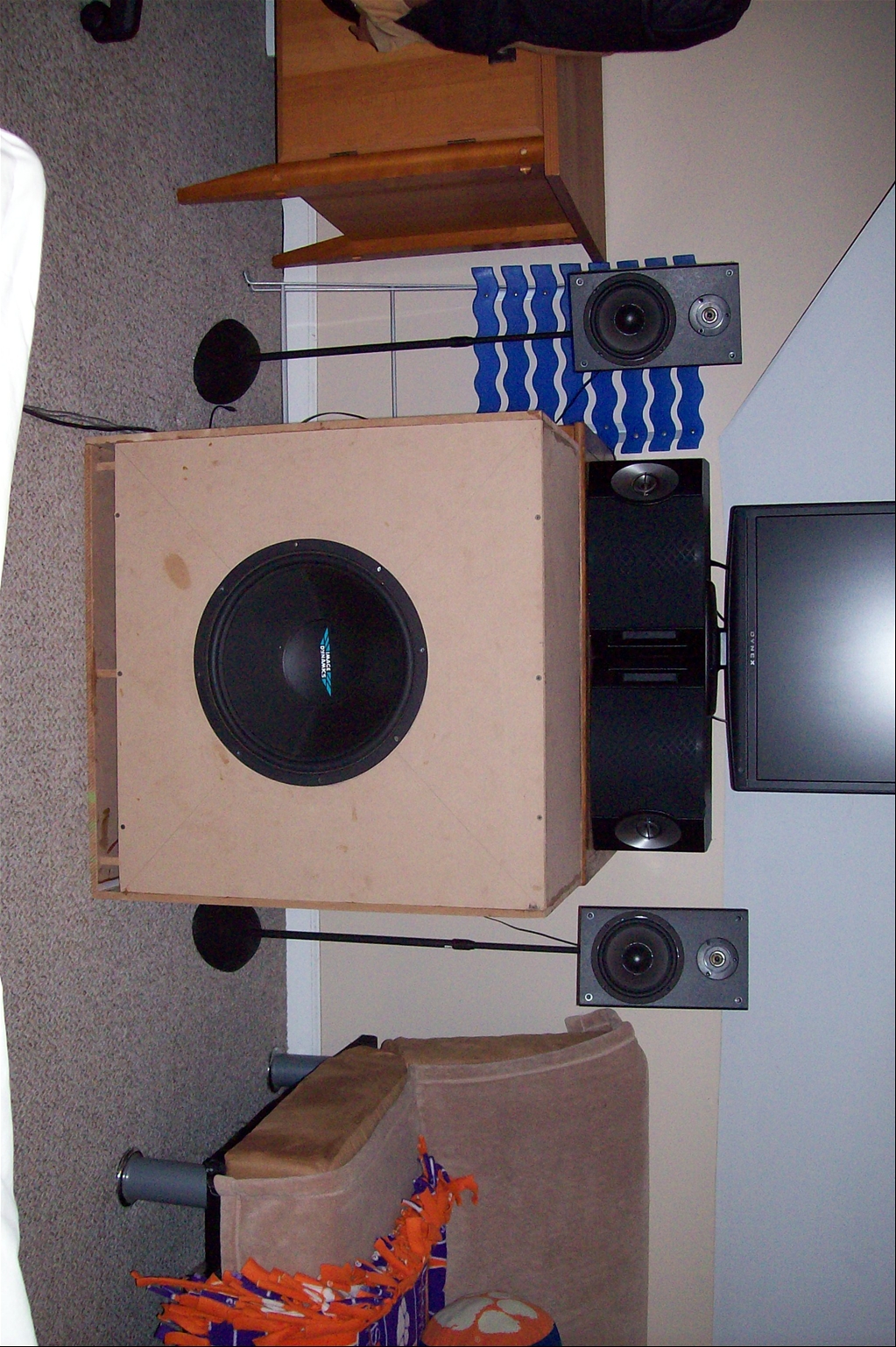

Sorry they are so huge and sideways, I dont know why they came out like that, my camera normally does a good job.
