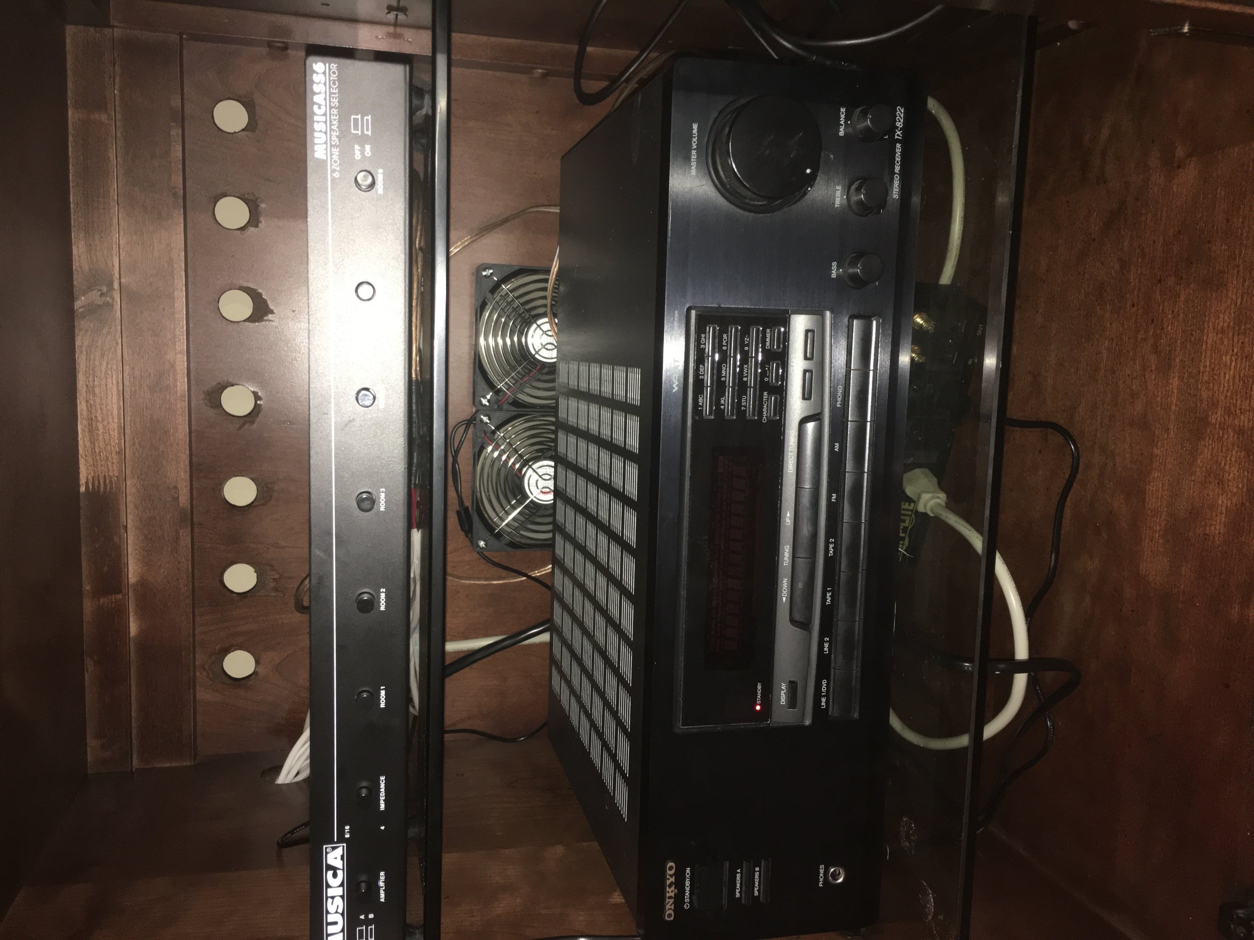

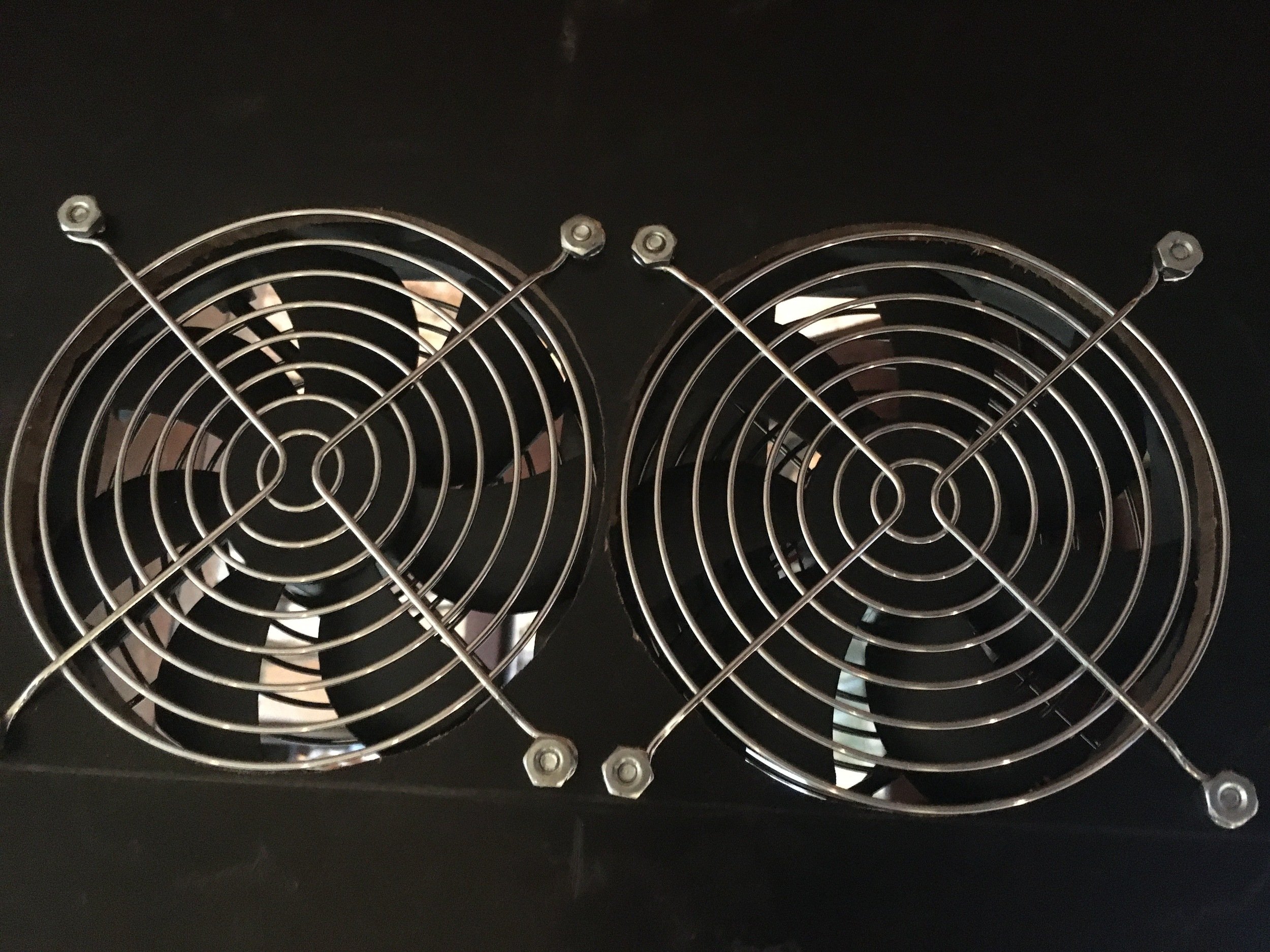

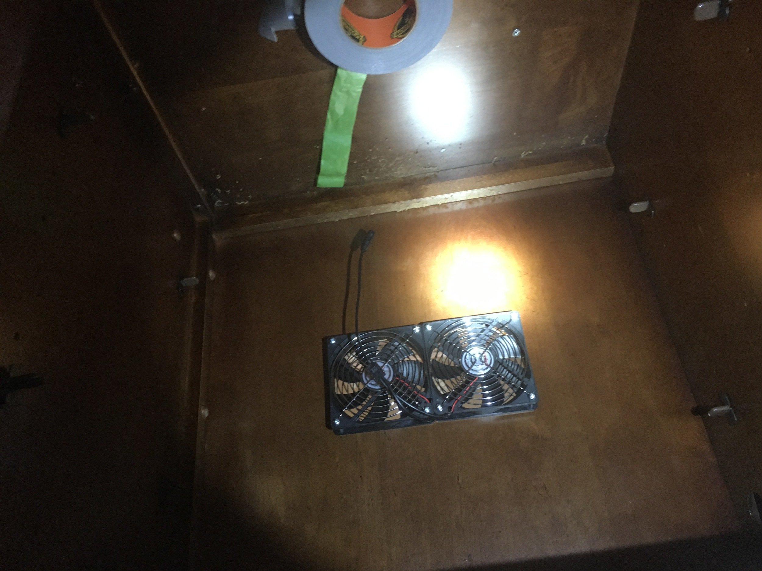

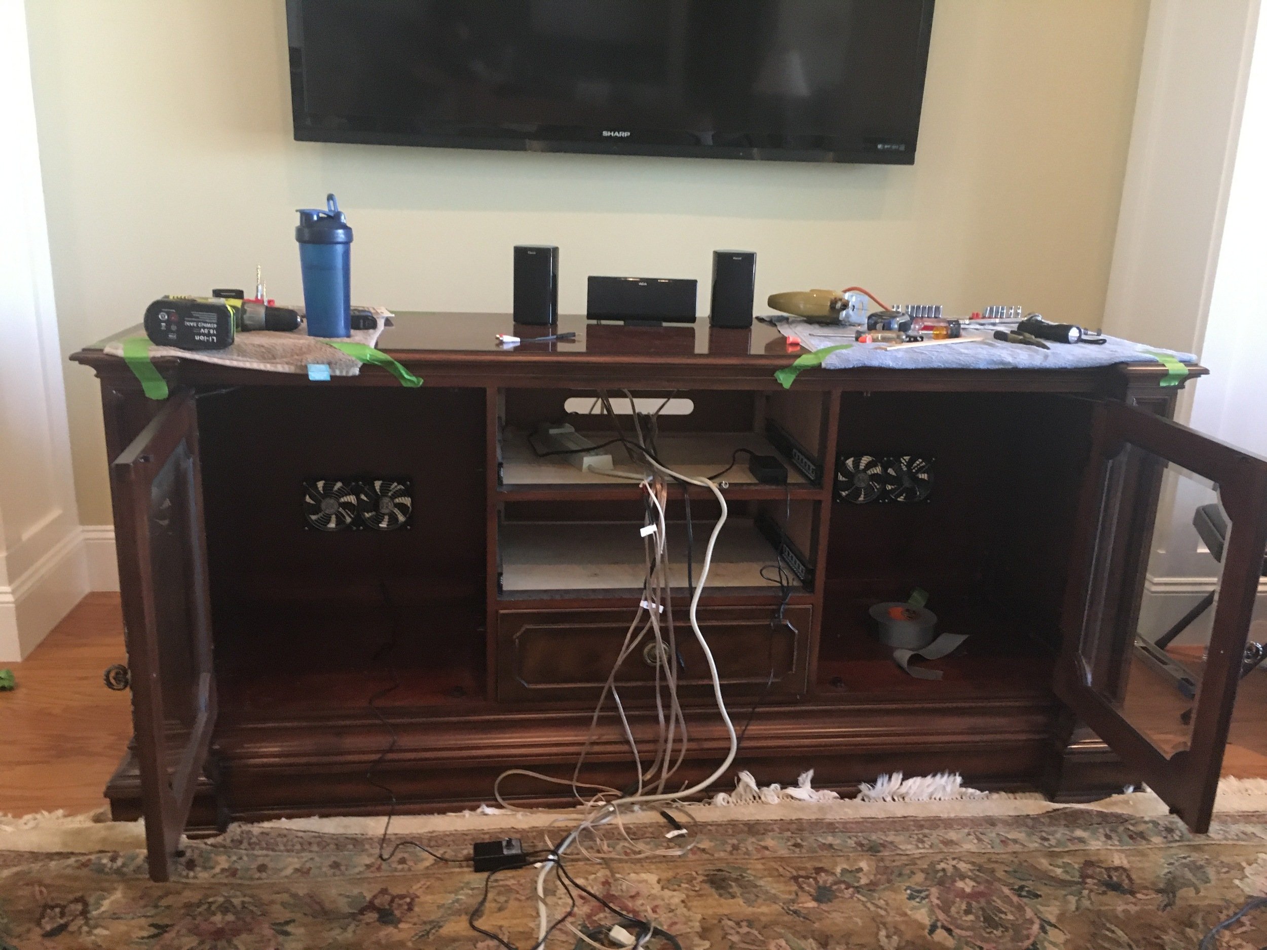

Testing fan fitment (first pic fans aren't tightened):

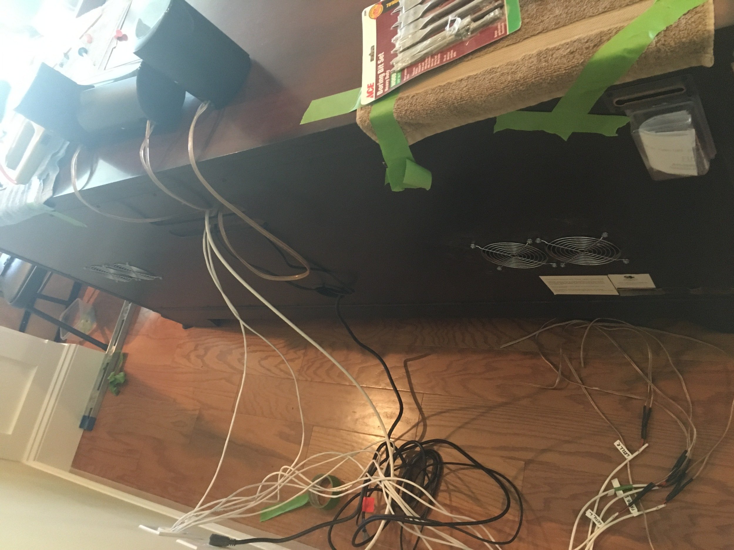

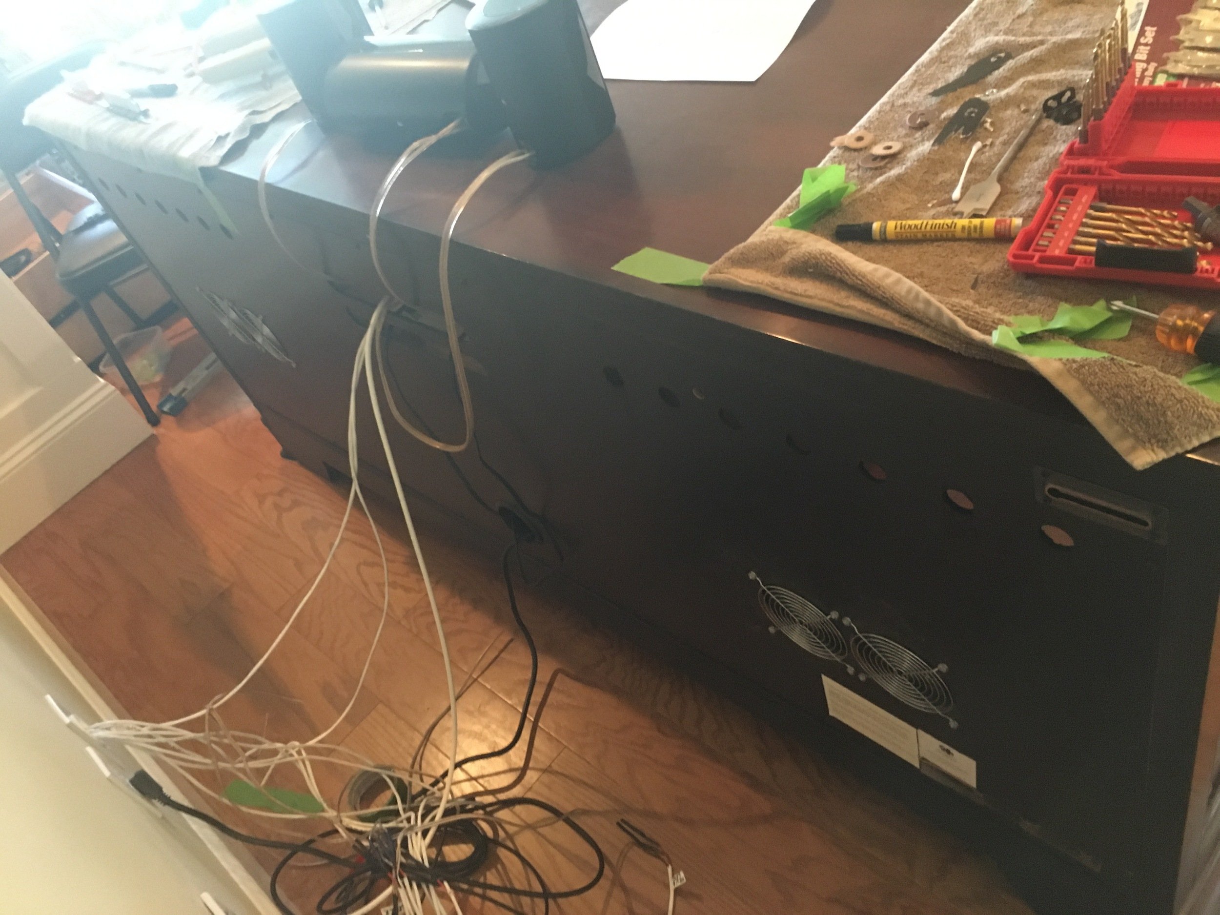

The next part is the "worst" part. I drilled 14x 1" holes at the top back for ventilation. I didn't know the back piece was a veneer covered piece on both sides, and it was really dense, all of it. Holy hell that was worse than birch, very dense wood and veneer. Some of the veneer chipped off, mainly on the inside. It was allowed to be done that way, nobody cared, you can't see it from any angle, unless you stick your head in the cabinet or look at the back of it, which requires pulling it away from the wall. This thing is very heavy. So I did color in where the veneer ripped and I colored in the holes I drilled, to make that bright wood almost black, so you can't really see much contrast when you see the holes.
29305
29306

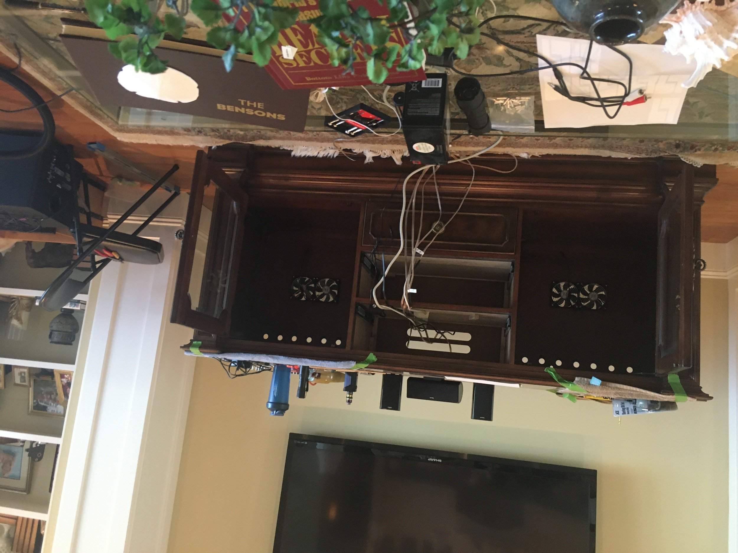

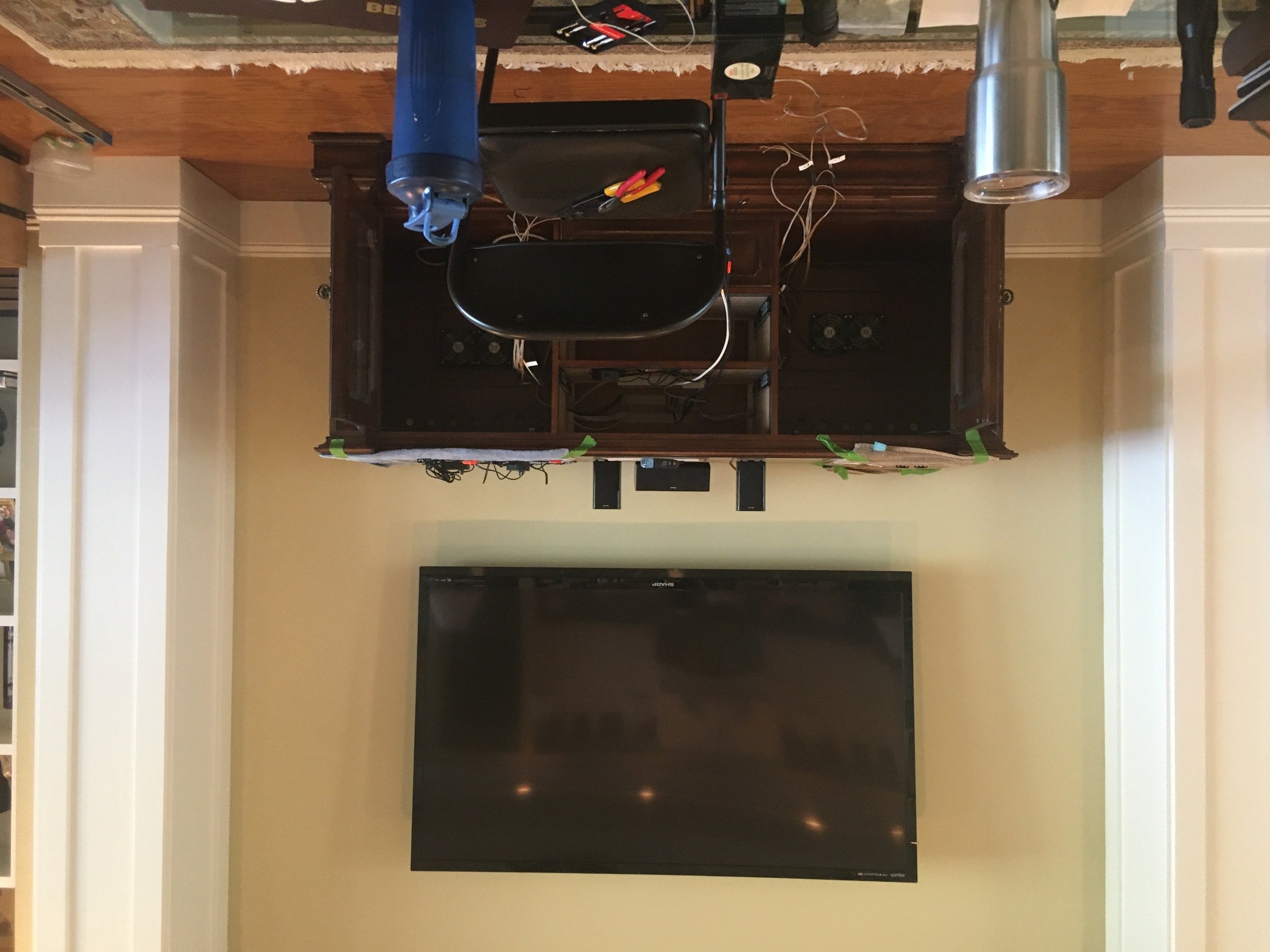

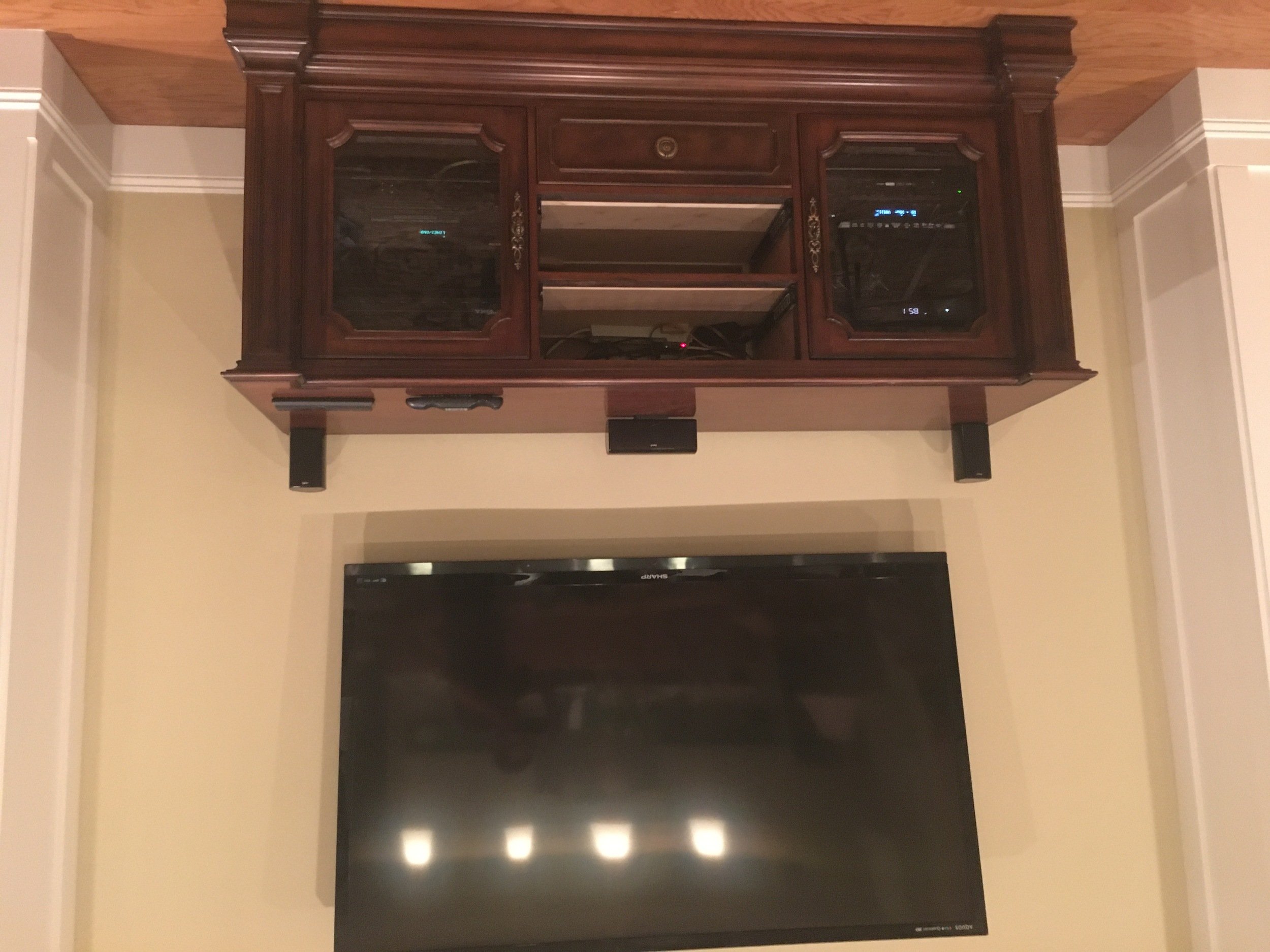

Pushed up against wall, most pic are with the cabinet away from the wall:
29307

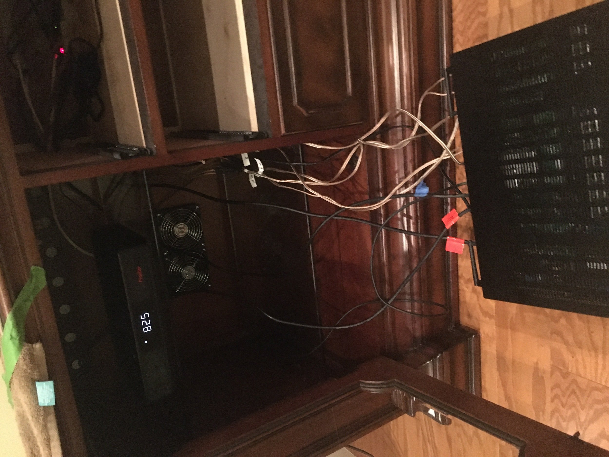

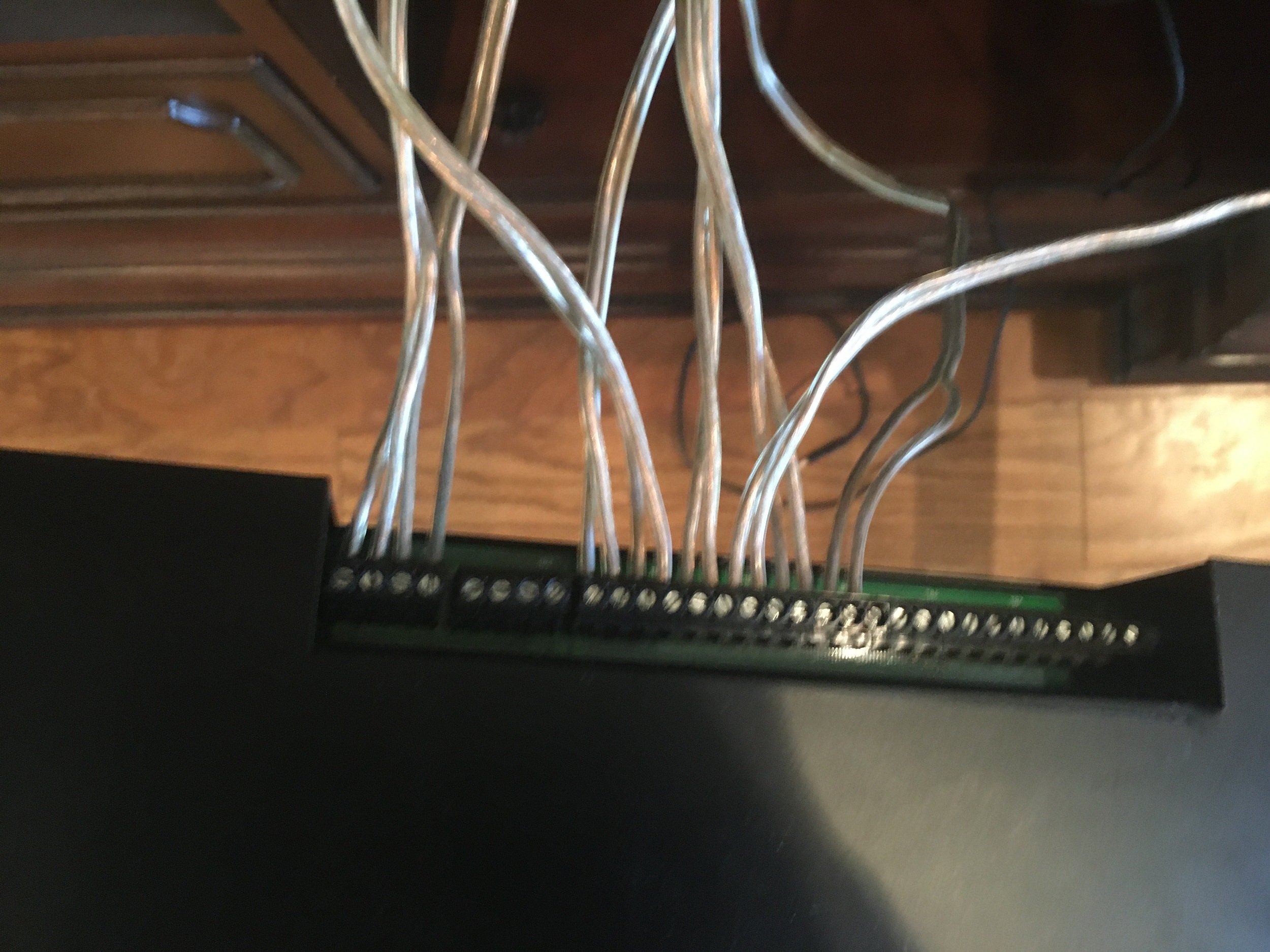

Final wiring! Except for sub wire and for output to second receiver for first receiver, those have to be purchased, still:
29308
29309
29310
29311
29312

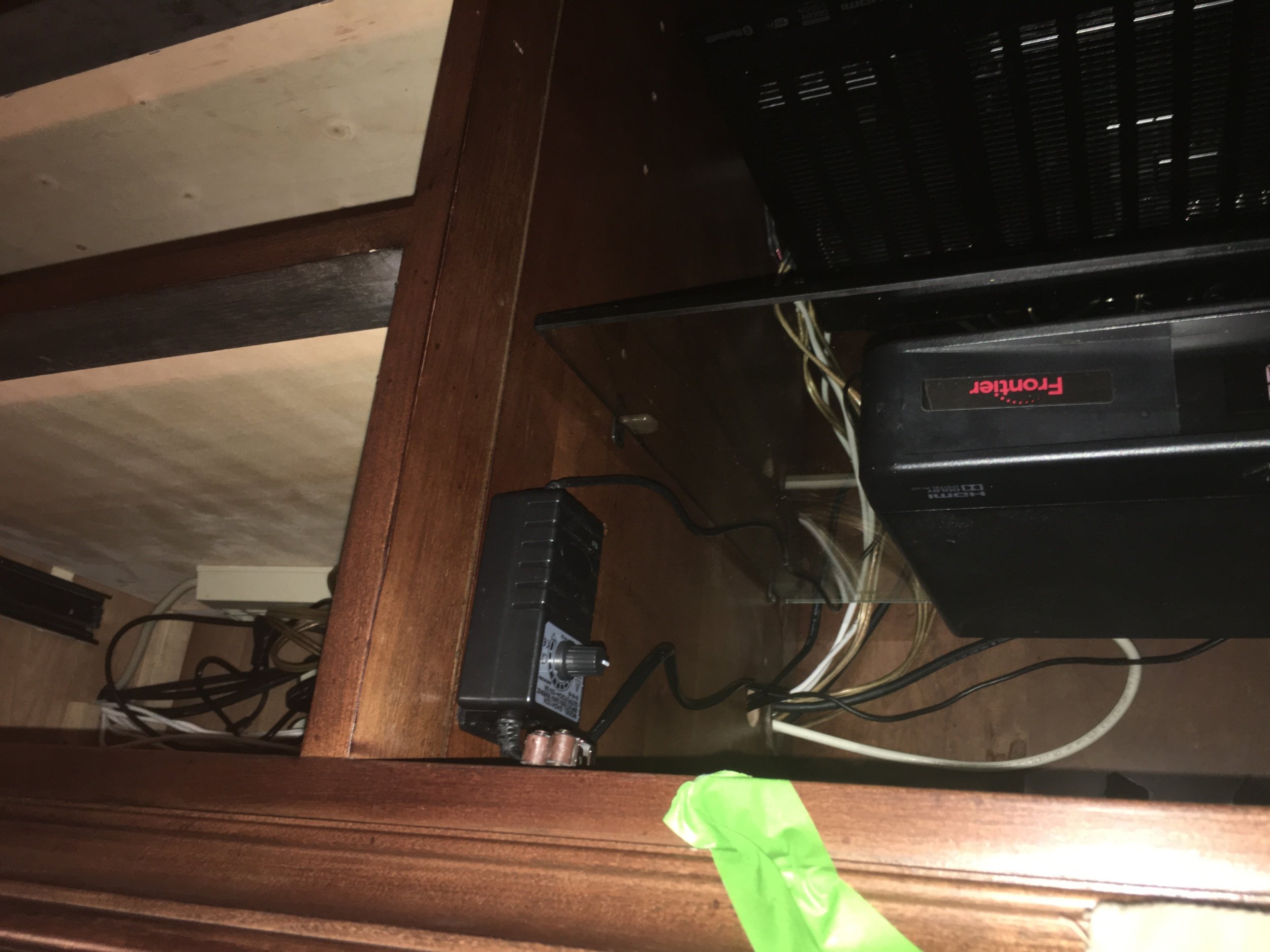

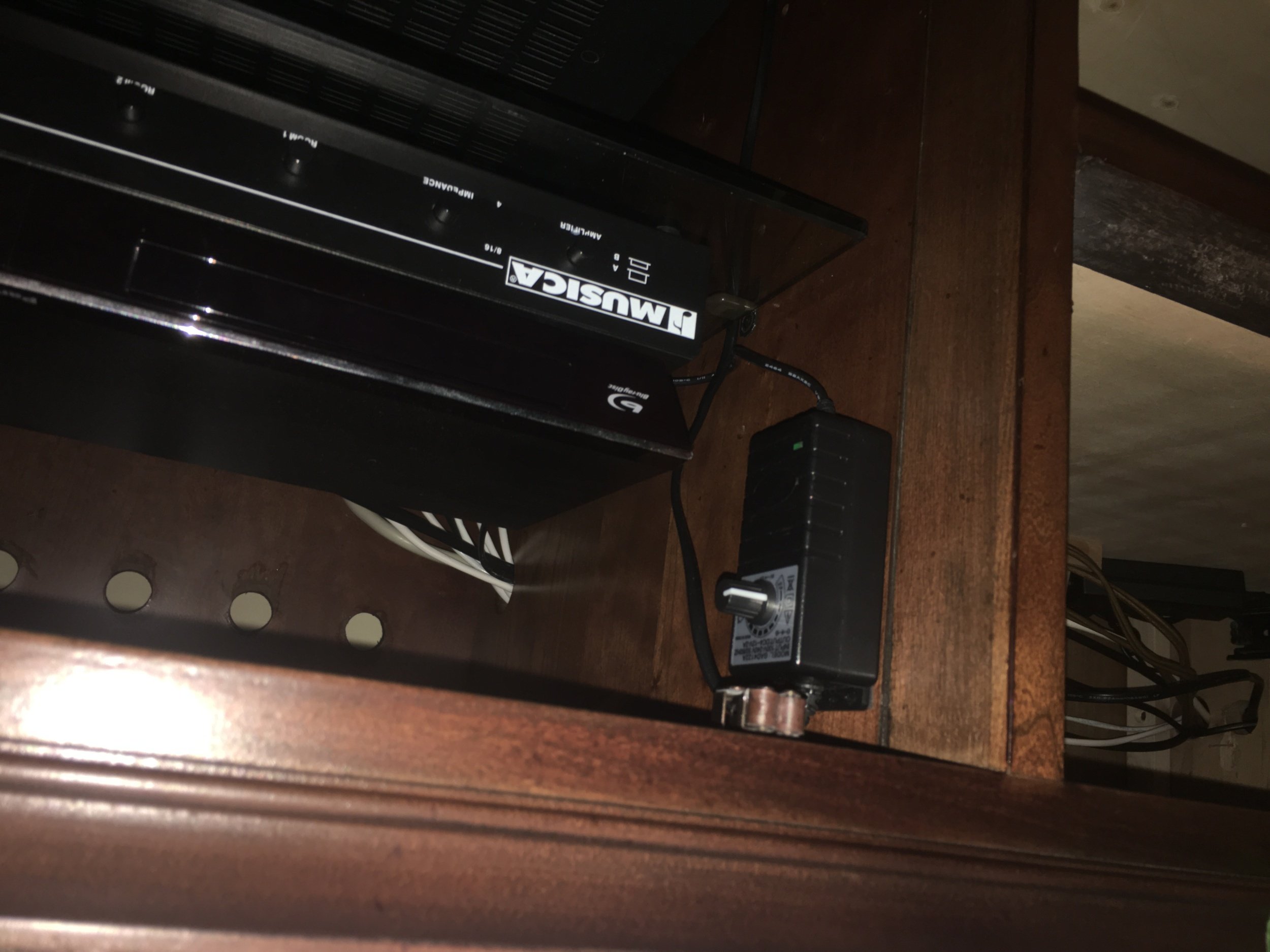

This is the speed controller for the fans:
29313

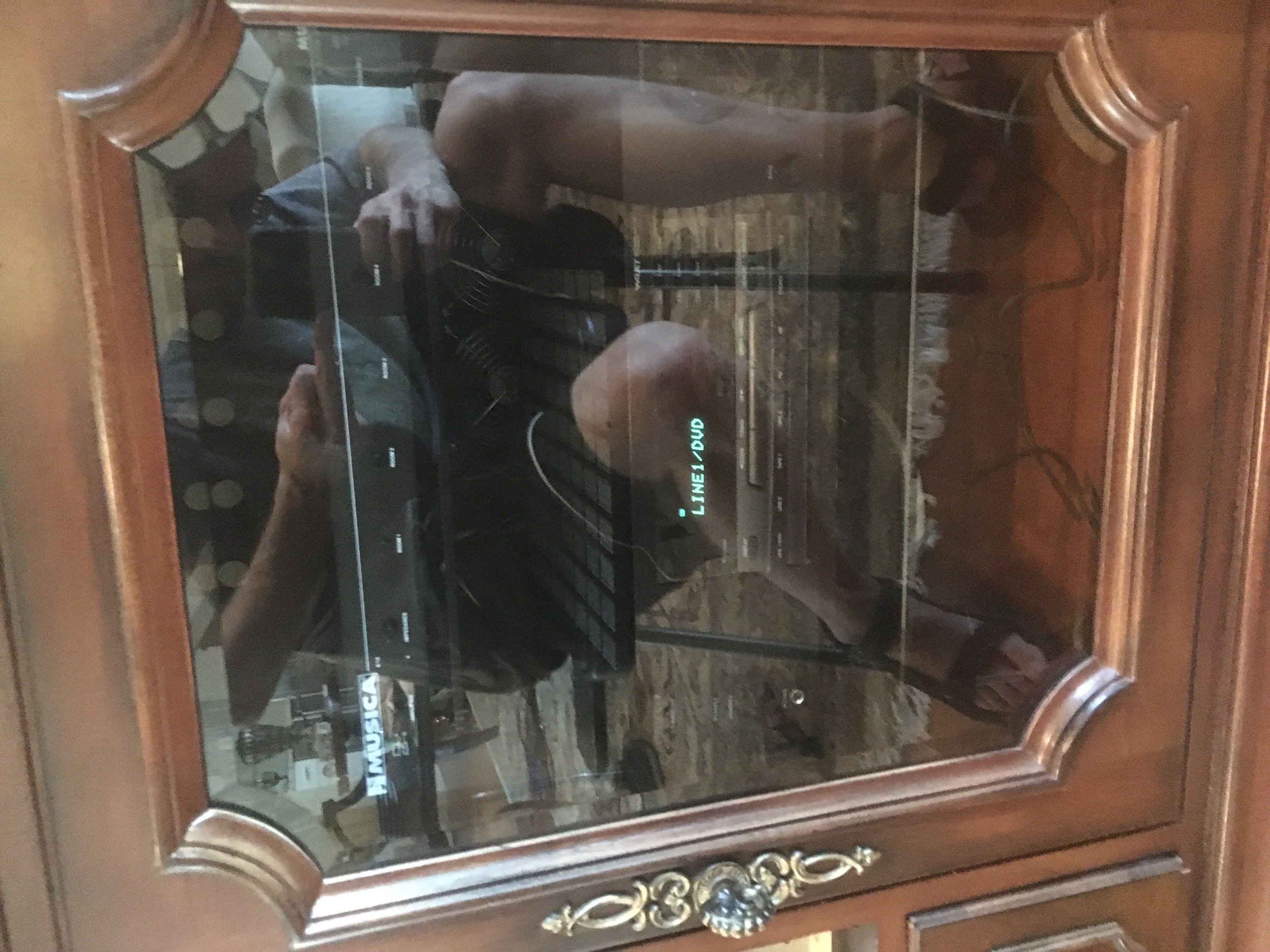

I forgot to take a pic with the drawers in lol:
29315

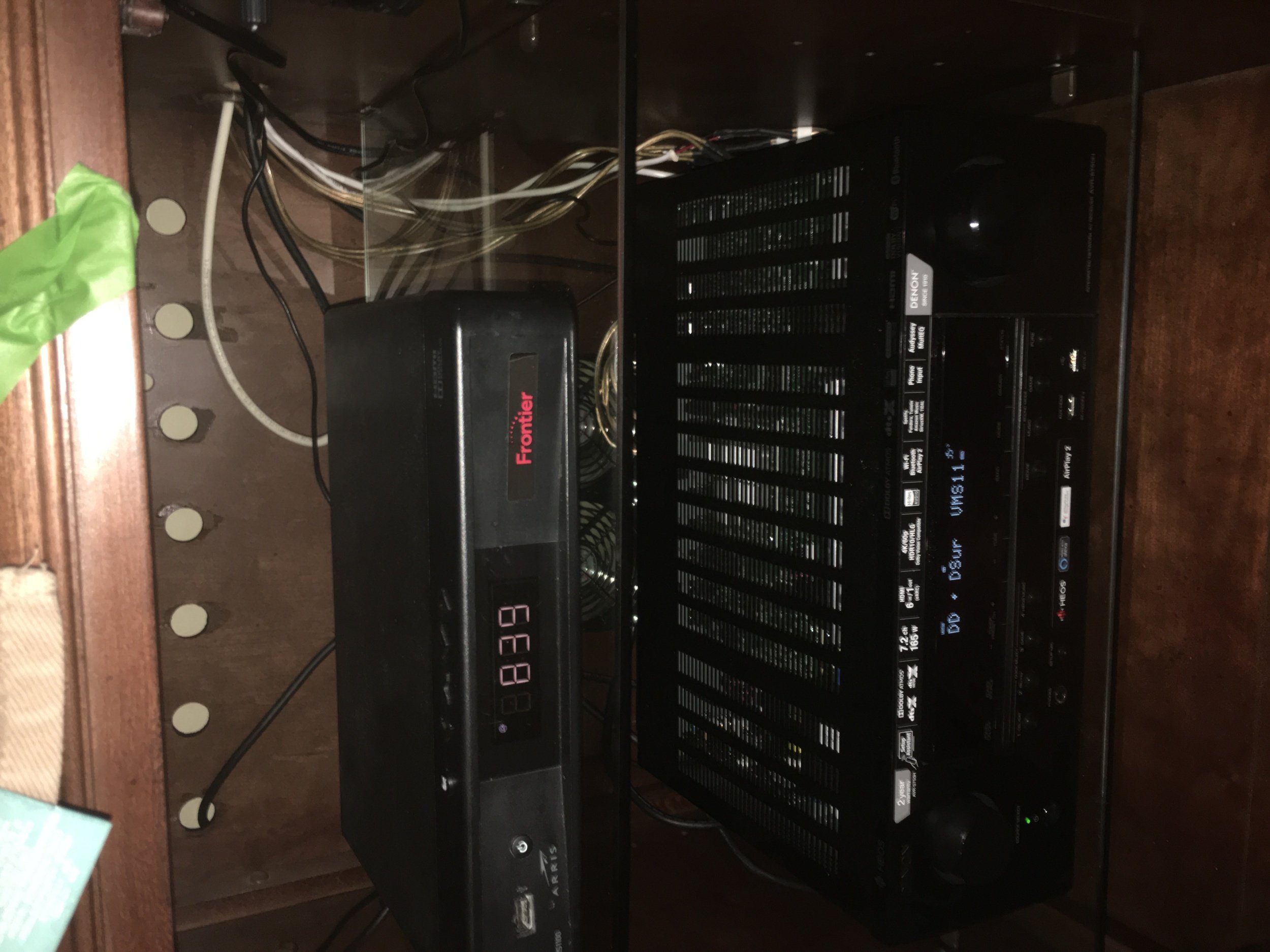

All the wires were left loose, there's a lot of length of wire in the cabinets, so you can just pull the receivers and zone selection board out if it needs service. Also left loose because I still need to add a sub RCA and some sort of audio output to other receiver.
The fans turned out well. One of the fans is a little noisy, just more than the others. But it flows air very well, the ventilation works. Fans are on the lowest speed, keeping everything cool and still pretty quiet. You have to be within a few feet just to hear the fans at all. You can being to hear them with the stereo on LOL.
So all 6 extra speakers worked, and the surround sound. Everything worked, for that I am grateful. That's pretty much it, I may add some pics from the sub wiring and whatever I figure out to do to get signal from the first receiver to the second. Time for rest, hahaha
