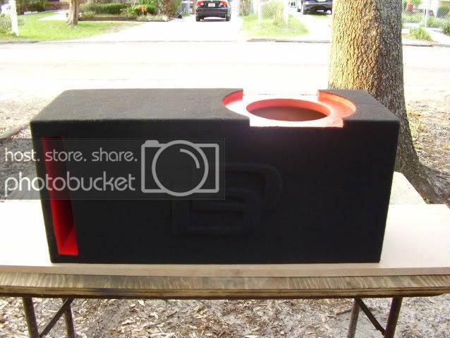

that sub should need about 24-26" of port area, a 4" pvc port dose not even come close to that.
imo, 1.5 cubes with at least 26" of slot port should do the trick.

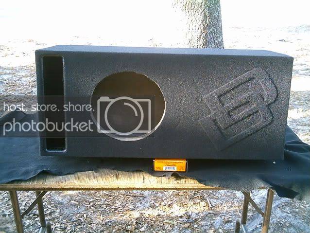

here is a pic of a box that was built for me (my specs), its 1.5cuft, tuned to 37hz with 28" of port. its for a dd 3510 and i fed it a solid 2k+rms(clean) and there was never any port noise and had shit tons of output.
Vic is right. The hdc needs 16" of port opening area per net cubic foot. You have 12" of port opening area for 1.5 cubes which is half of what you need. Vic's box is right on.
that sub should need about 24-26" of port area, a 4" pvc port dose not even come close to that. imo, 1.5 cubes with at least 26" of slot port should do the trick.
k, i'll try a slot, havent done one in years so why not. I guess i've never built a box so far off cause I can't believe it would have that much of an effect. Hopefully that will do the trick. we'll found out in the next couple of days though.

trust me, that box was a complete night and day diffrence. check out dd's sight on their box building and designs. i even have a box for a 1508, 1cuft tuned to 38hz with 19" of port and it has the same outstanding results.
now some subs dont need or like this much port but the rule of thumb is 16" per cuft of air space. seeing as how aq is the "twin" to dd, i would think this port formula would be near perfect for your app.
