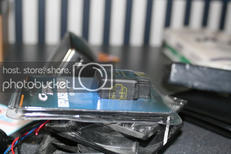

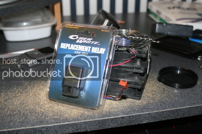

i got myself a relay and some 120mm fans, but i am not sure how to wire it all up. i have a 12v source int he back via a YT and two amp turnon leads. how should i wire this all up so it works right? never hooked up a relay before so a dewscription on how to install it would be helpful thanks
equipment:
numbers on left side are 87 top 30 bottom and right side are 85 top 86 bottom
Ground 85. 86 is where you put the remote wire from the amp.
30 goes to the positive battery terminal.
87 goes to your fans + wire (most likely red or yellow) and remote terminal on the amps.
Ground the fans to the battery and you're good to go.
