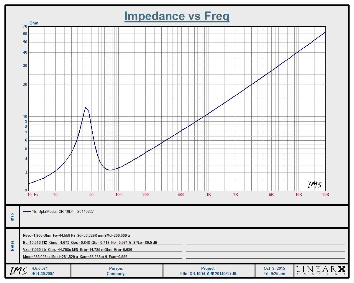

Had to call American Bass about t/s parameters for my set of XR10D4 subwoofers. They got em to me super fast, but this is the first time I've used win isd and I'm having issues. I cannot get the driver saved to start a project, it said error when I tried to save them. I recall hearing that they need to be input in the right order or something. I'd be grateful if anyone can help me to get this driver saved into winisd so I can design some boxes.

Make sure you are entering the correct measurement ( ie grams,kilogram etc. you can change the measurement by clicking on it)and there are some parameters you want to let the program automatically enter. Double check if the parameter is the same or at least very close to what you have when the program automatically enters it in. This will be a clue that you’ve done something wrong if it’s way off. Easiest way to tell you if it’s going to auto enter is after you enter the first couple of parameters tab and see if the program does it for you if it doesn’t go back and enter it before going to the next. Iirr you need to enter qes qms fs vas mms re Xmax pe and number of voice coils. The rest of them the program should do it for you.
It’s been a while since I’ve used winisd (use bass box pro) so my memory could be a little off but hopefully this helps.
Hopefully a/b gave you a detailed list of parameters to simplify things for you.
