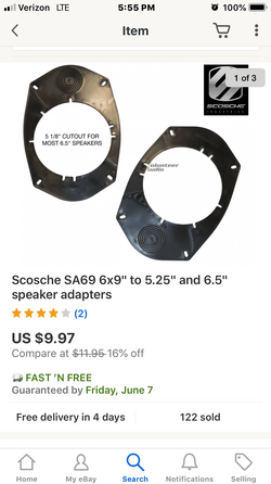

Then start replacing speakers as money allows. Ditch the 6x9’s, and run a nice 2-way 6.5” passive component set up front. Then upgrade your sub, and use a proper box.
