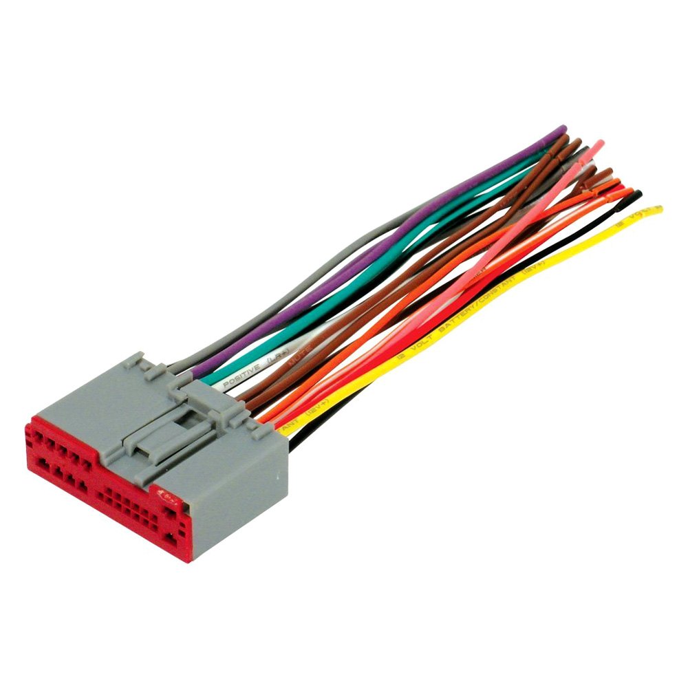

This is a replacement wiring harness that plugs into the back of that radio. You can take the part number from scosche FD23RB and go from there.
Your best bet is to buy one of these locally and then plug it in. Each wire is color coded and has what it does typed on it in english or if you are lucky enough your language
edit: idk why it says security check but it goes to carid.com and has the harness you are looking for
or type in Scosche FD23RB as said above in the 1st sentence

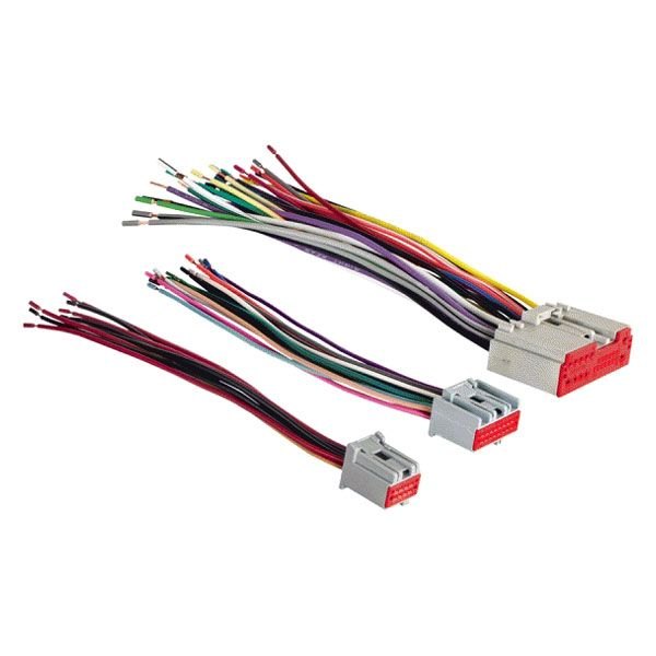

Do you mean that connector ? If so - the connector no way to fit in the unit
