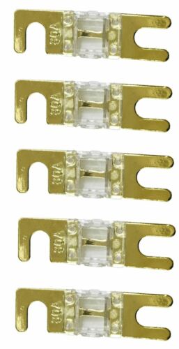

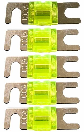

I would recommend a Kenwood/JVC ,Sony, Alpine 4v-5v HU with min of 2 RCA Out or 3. I would not put a Pioneer HU in. Pico Fuse issues and they are not made of quality anymore to last.
Amazon product ASIN B009XUM06A
For the D.Bonce 2 ch amp.
For the CT Sounds Mono amp.

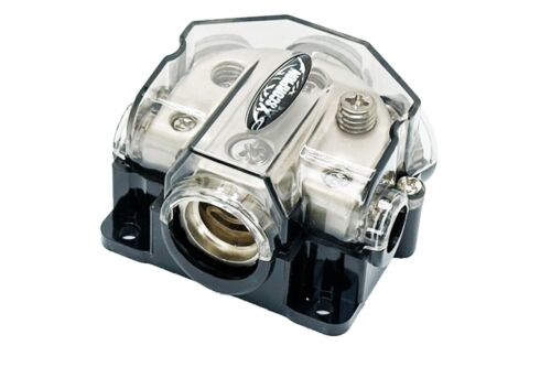

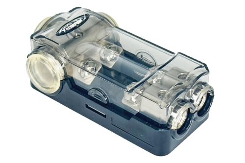

4ga wire by the Ft. for ground and supply for both amps. Might look around like @ GP Audio and KnuzKoncepts even.
