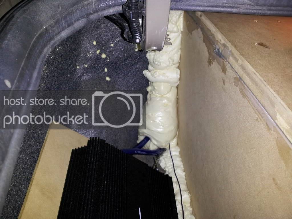

hi Brahs!!! so Little update!!
I took out the sub from the trunk to test it and surprise, it was leaking everywhere!!! basically, they used the outer carpet as sealant, and nailed the cheap "MDF"
there where gaps up to 1cm!!!!!
I sealed everything with some Wood-silicone, and everything changed radically.
still bending everywhere, but at least, its sealed, and all the air exits from the port. the sound is nothing special, sounds.
hair is moving fairly, if i volume up, so good sign, i'll put a video on YouTube soon
next step, stuff some wool, maybe it helps with the bending and bad quality MDF. its not even MDF, its pressed carton.

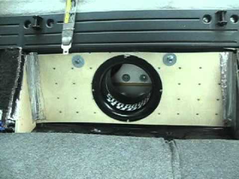

We told you this on your old thread. Port and subs should be on the same plane or port has to fire to the trunk especially in a trunk or you seal it up and wall it off from the trunk completely. I cant believe you have a leaky sealed box made with particle board and a port opposite direction from it. Here this is whats good or not good cancellation 101. Trunk hatch is on the left side, cabin is the right side. Difference between good A Vs Bad A is a trunk wall you have to seal the subs and port completely off from the trunk, nothing can get back inside the trunk or else you lose ALL bass.

your box cant be any of these configurations because the subs and port are on opposite ends so all you get is "bad x infinity regardless of your orientation"  only way it might possibly work is if you have the port fire the rear towards the trunk.  In a ported configuration, the face of the subs is not important, its where the port is facing which is important. You are technically at bad A in the diagram.
Definite no on the 4th order unless you use 10 inch subs. 4th order for two 15s would only fit in an SUV taking up all the cargo area space means its a BIG fking enclosure that will never fit in a trunk EVER. two 15s ported enclosure is already hard to fit in a trunk let alone a fking 4th order..  So dont go from one f**k up to another f**k up man. like I said, you have no idea what to do so have someone else design your system for you and the enclosure as well. You are just wasting your time with all your ideas.

it has to be a pretty big port, not that tiny port you have, the box will take up the whole trunk. You also need to completely seal off the trunk. BLOCK EVERYTHING OFF, prevent any kind of sound or air pressure from going into the trunk or else its not going to work. You dont just seal off the sides of your box, you need to seal off your rear deck as well. Absolutely no kind of open hole that has any sound or air leak from the cabin to the trunk.
If your subs work well in a small sealed box, a 4th order for both 15s would work but you literally would have to build the box inside the trunk and it'll be a very permanent thing and would 100% be above your fabrication skill level I'd think.
