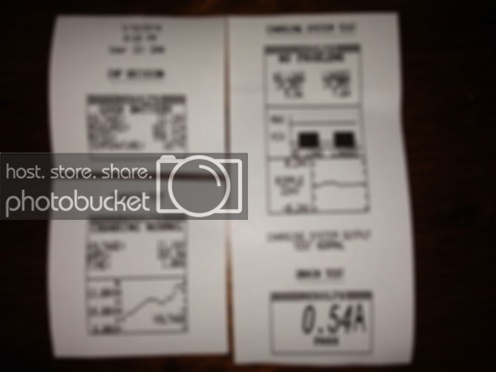

Stopped on the way home and had the battery and alternator checked. Here's the test results.
Passed with flying colors. If you notice the battery is rated at 550amps and actually put out 680+. So what should I start changing first??
7.6A with a load seems kinda low to me. Were the headlights, a/c, radio, or anything else on in the vehicle when they tested? With a 1.5A difference between no load and loaded doesnt seem to be a conclusive test on what your problems are. do big 3 and uprade battery
